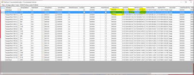

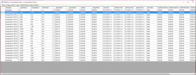

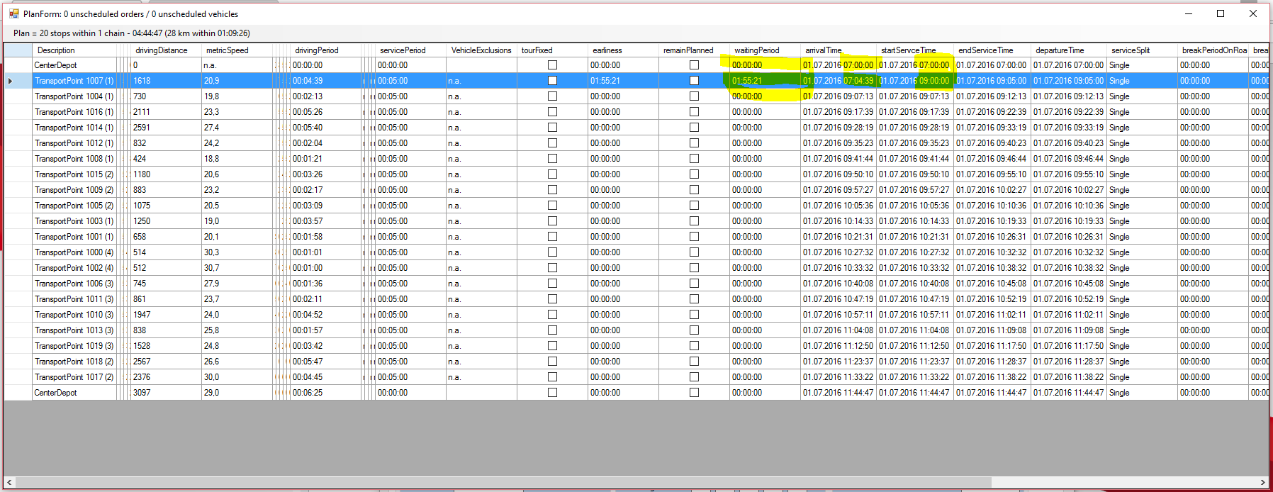

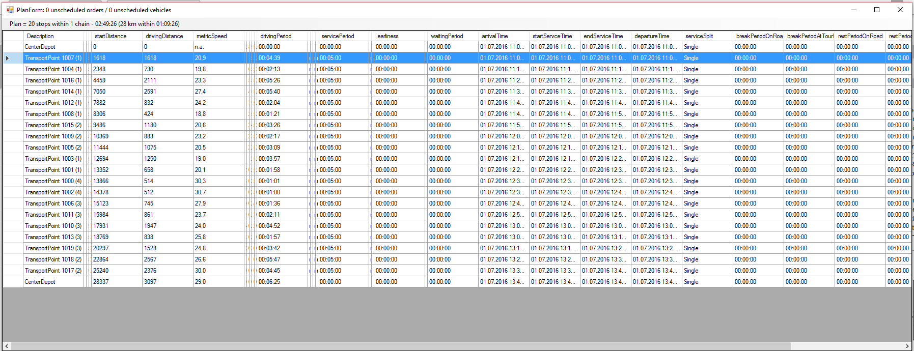

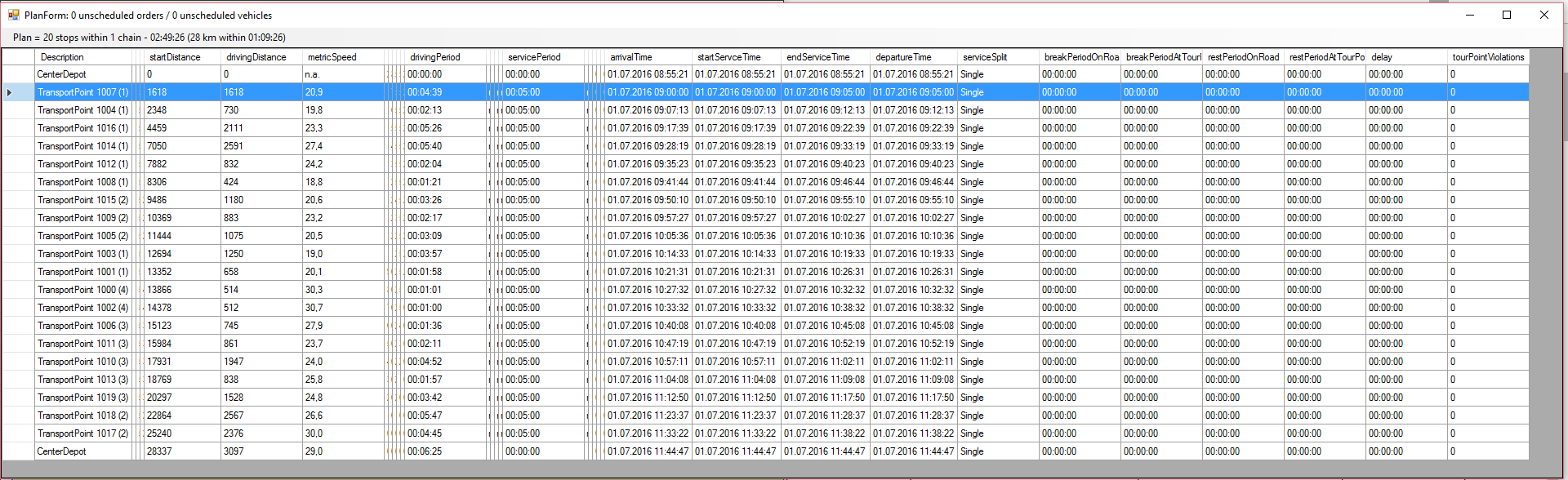

you could also use startTimeFixed without an input plan. Here are some examples with same restrictions
  • 20 orders of 5minutes
  • 07:00 - 17:00 operating interval
  • 09:00 - 18:00 opening interval
just the startTime is different:
StartTime not set. Tour starts 08:55, first customer is visited at 09:00.
StartTime set to 11:00. Tour start at depot is 11:00. First customer to be visited: 11:00
Start time set to 07:00. Tour starts early, arrival time at customer produces waiting time because opening is at 09:00.

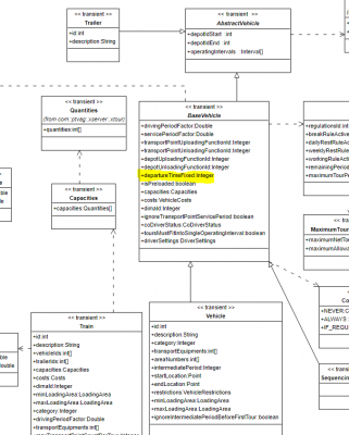

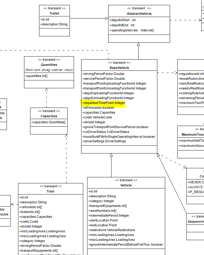

Probably you need the Vehicle's propertie departureTimeFixed?

Hello Bernd,
this is amazing! it's exactly what we need. Interesting how both sebastiano and me didn't see this when we looked at the docs :D
