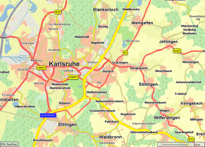

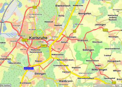

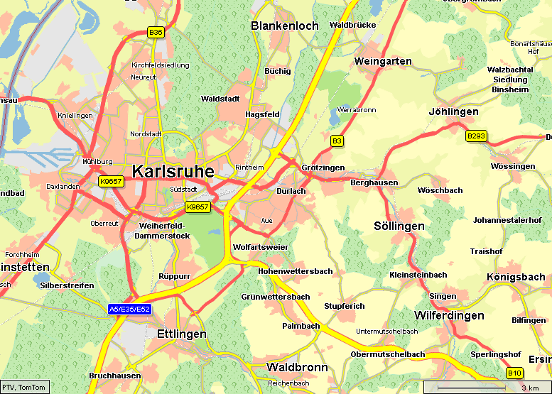

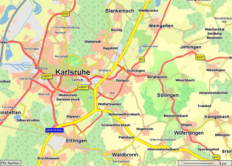

to visualize the greenzones / low emission zones in a map you need to refer to a render INI file that contains proper greenzones flags, e.g. "greenzones.ini". Here are two screenshots to be compared:
The default profile. It does NOT visualize the greenzones.
Request uses profile xmap-greenzones.properties which refers to greenzones.ini. The greenzones of Karlsruhe (small region within the city) and the neighbour city of Söllingen (area arounf the city) are highlighted.
