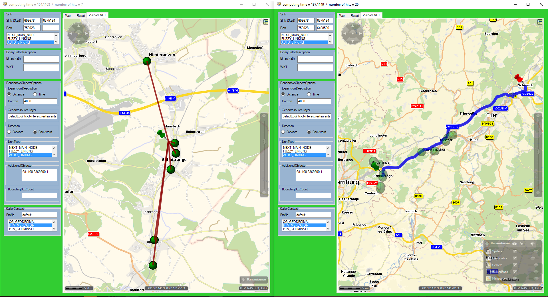

  • Center is point versus polygon: sometimes it makes a difference whether you are looking for objects close to a given center coordinate versus along a precomputed route. For both approaches we offer proper interface methods.
    Center based (left) versus routing corridor based (right)

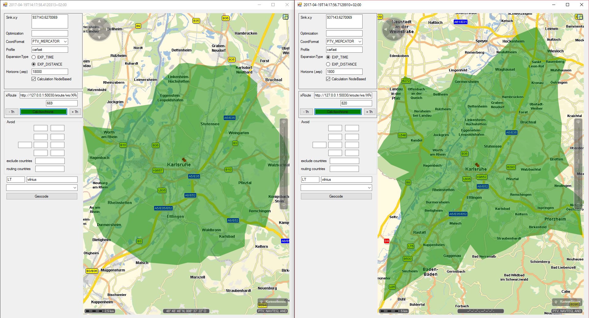

  • Is the distance itself important (e.g. for the sorting order of a result) or is it just the computation of “who is inside”? If the later is the case you can check whether precomputed Isochrones (xRoute.calculateIsochrones) can be stored in a spatial database which supports SQL search based on geometry objects. This is a proper usecase in a callcenter where service levels (who can reach me within 60minutes based on static homebases?) are important for a quick search that can be refined afterwards (calc the matrix for each candidate).
    Isochrones. distance based isochrones usually look more like a circle while driving period based ones follow the street network (high speed on highways: longer reach into that direction).

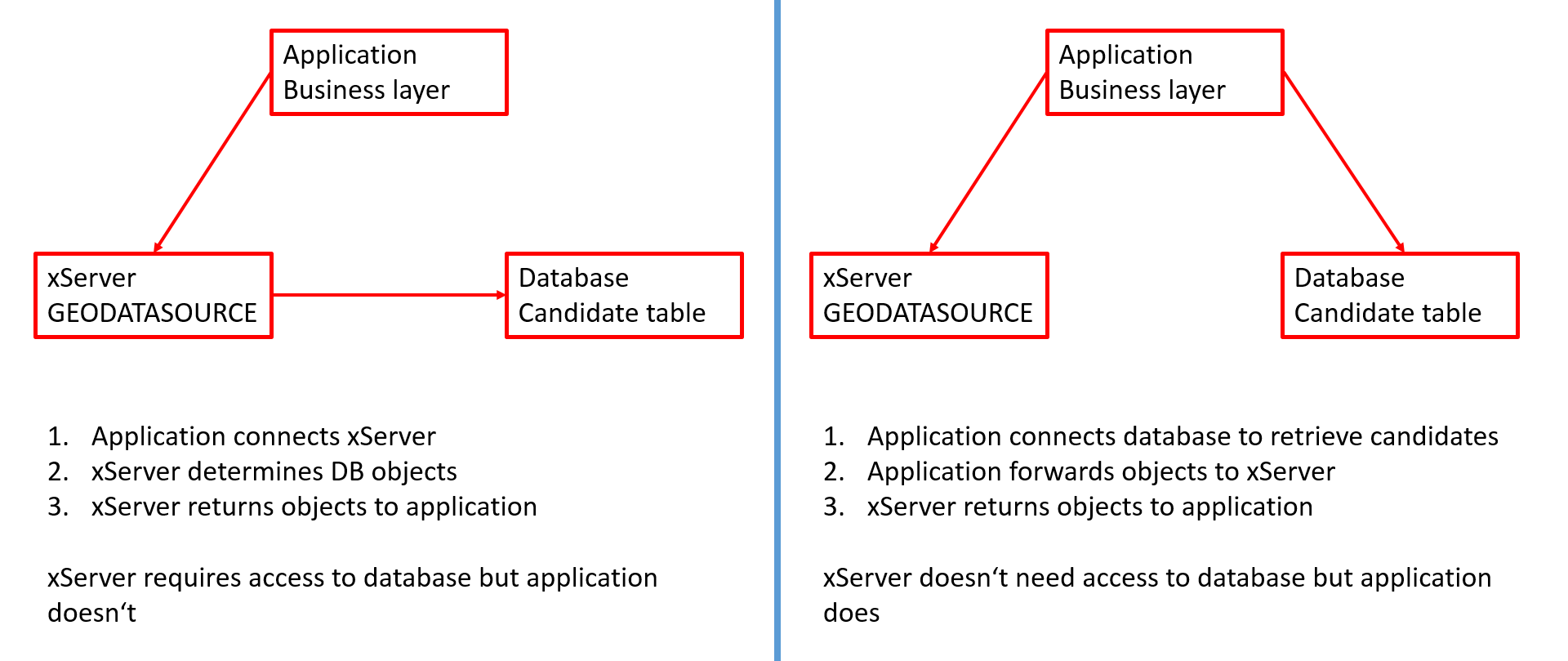

  • Are the candidates (static) objects stored in a database? If this is the case the geodatabase search of xRoute could provide quick access to the search: the xRoute itself connects to the database in the backend and determines those objects that are candidates and validates the “hits”. Sometimes the objects could be more context driven which means the application retrieves the x,y-coordinates of objects and forwards them to the xRoute method call.
    SearchForNearest supports both approaches. But be aware that depending on the application context not all connections to the database are allowed.
    database connection: do you want to connect the xserver to the database or should the application take care of the connectivity? Sometimes you don't have a choice because the architecture defines constraints.
