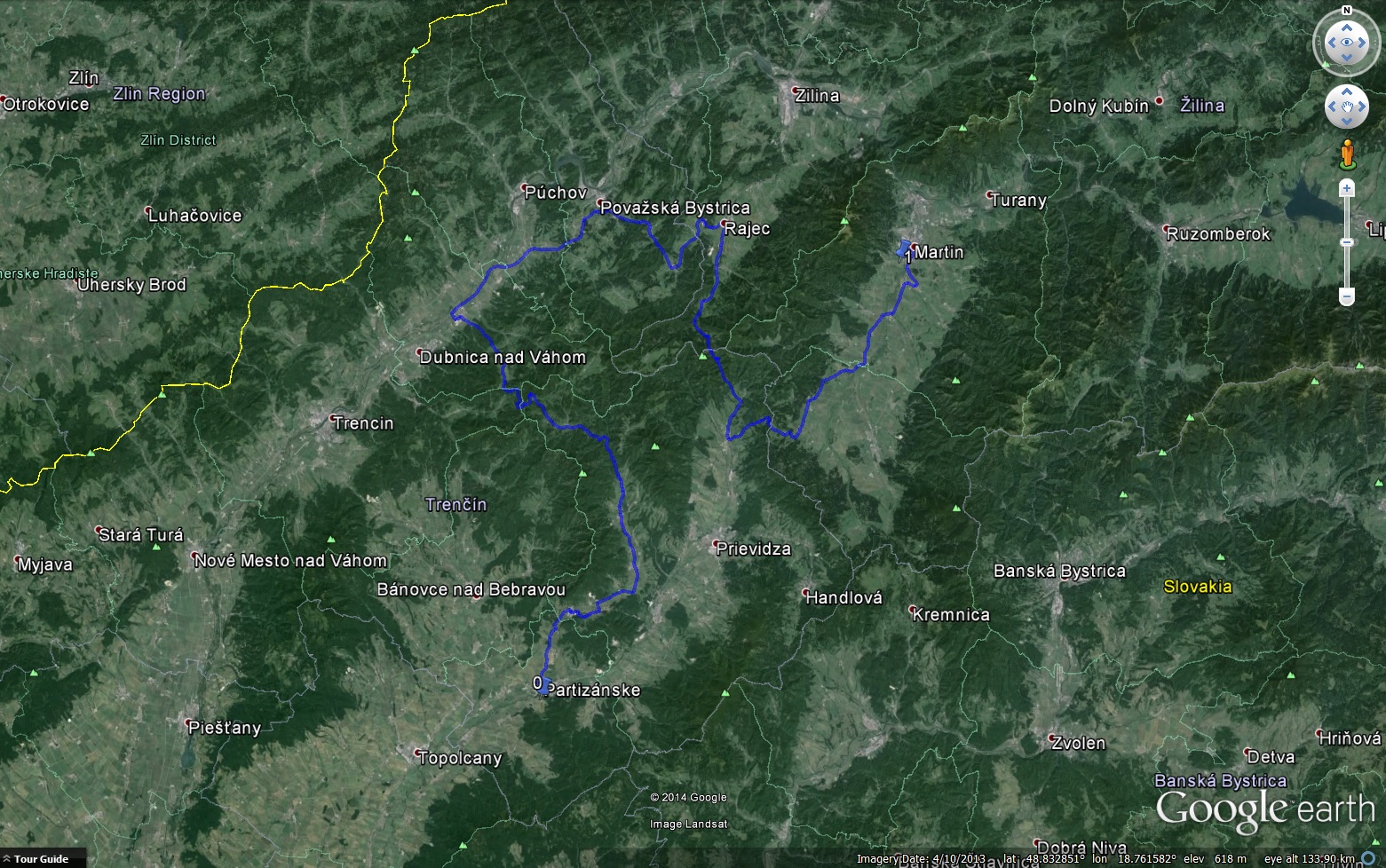

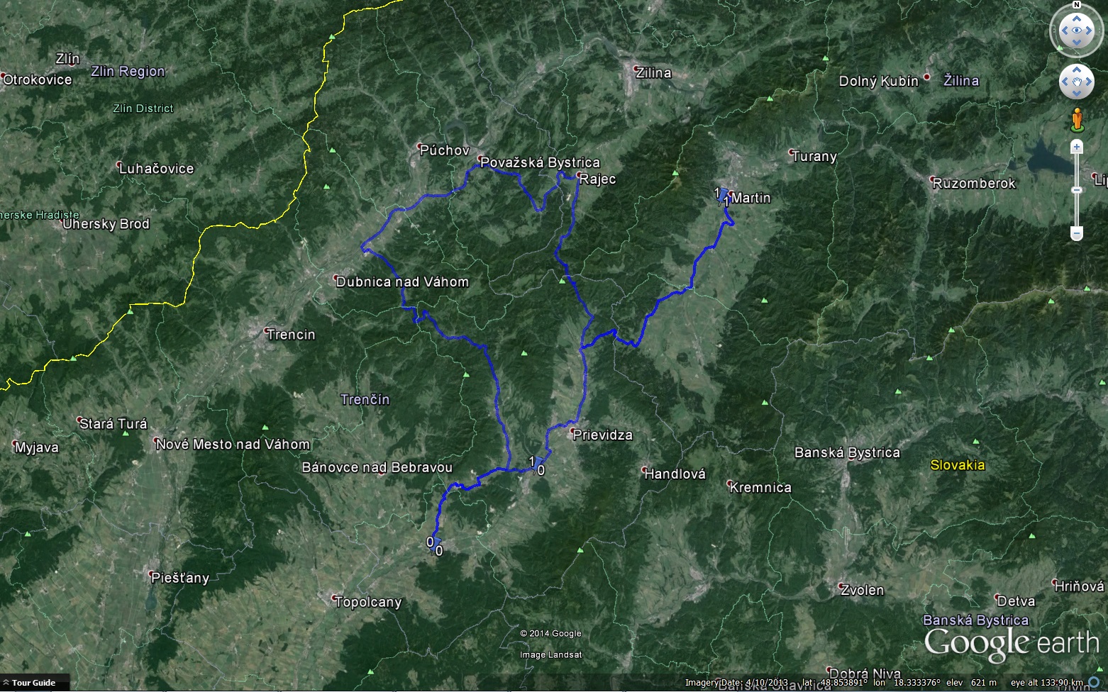

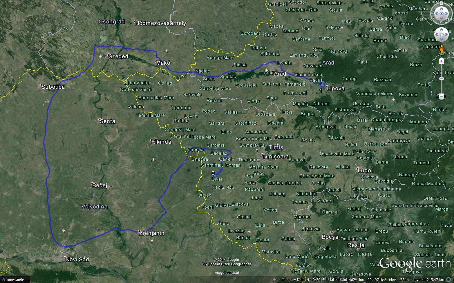

We have found some cases where the planned routes are very circuitous.
Attached please find some pictures of these results. The Ro2 picture shows a route in Romania and the Ro1 picture shows that if we give a point in the middle then we can get a better route. The same happens in Slovakia as you can see in the pictures Sk2 and Sk1.
We are using PTV 1.18.1.1 with the default mg-truck-40t profile and LinkType.NEXT_SEGMENT for the WayPointDesc.
The coordinates of the points in the examples:
3 points in Slovakia:
Partizanske 48.625902, 18.361612
Novaky 48.724055, 18.554867
Martin 49.060550, 18.905037
3 points in Romania:
Uivar 45.661012, 20.897677
Timisoara 45.772853, 21.1988542
Lipova 46.101194, 21.661833

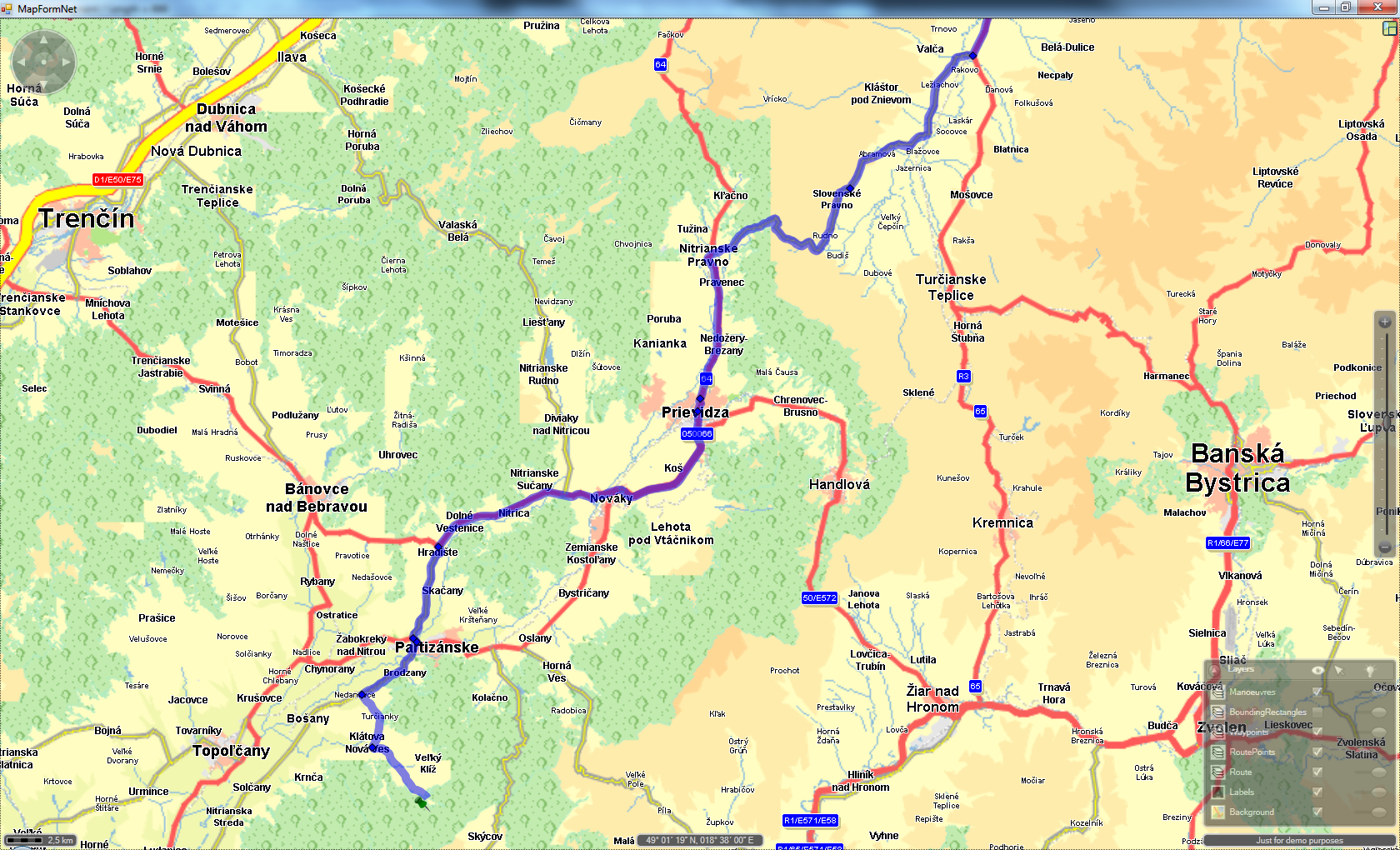

Look at this screenshot:
country roads
country roads
As you can see the routing track uses some trunk roads that are located at about 50km from the start - tehy might be unavailable in the data setting you use...
the map
the map
Maybe this is the cause for the issue?

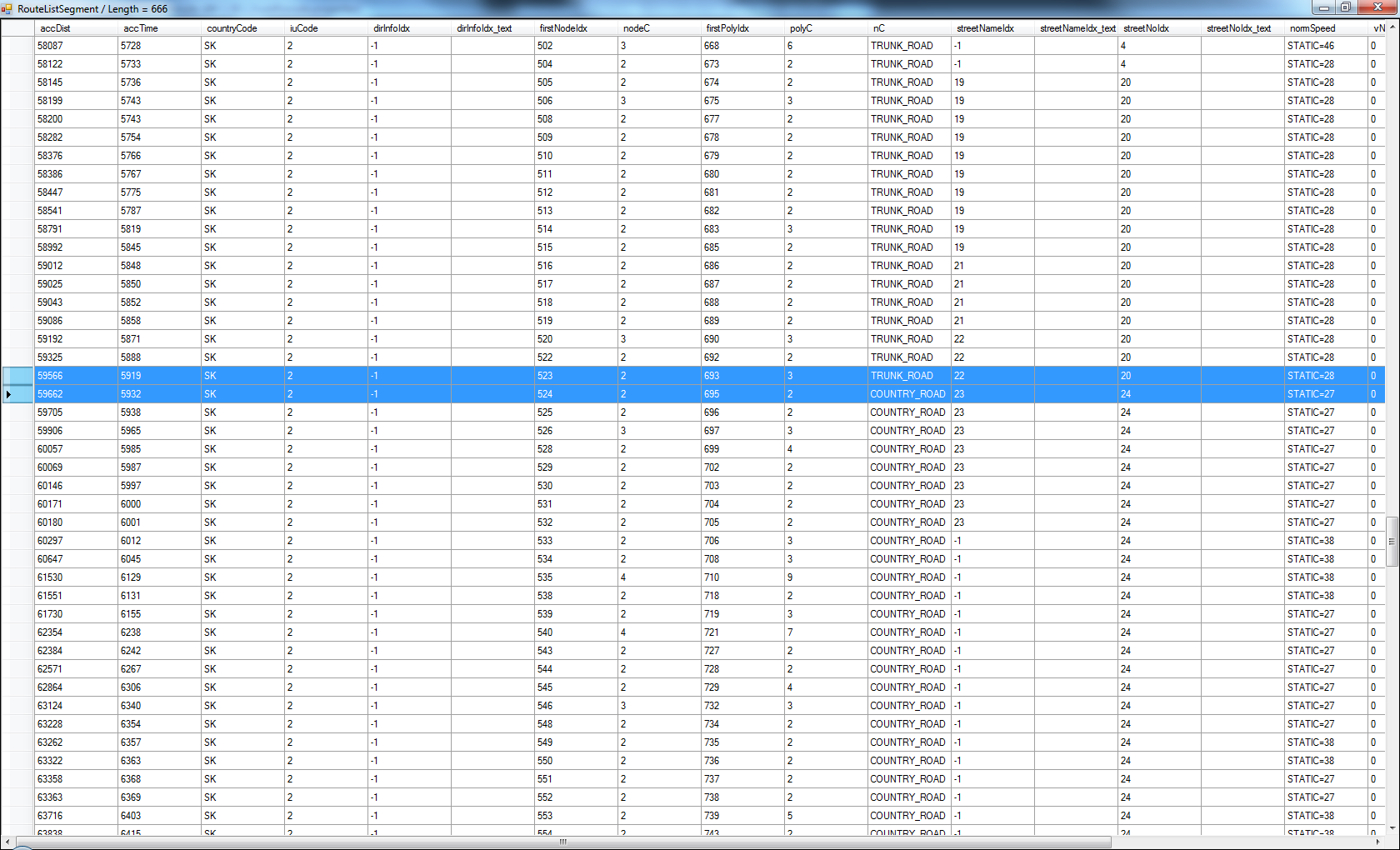

I computed the default track incl. TruckAttributes data but without vehicle dimensions:
Some segments have special attributes:
<ns3:segmentAttr isPiggyback="false" lowEmissionZoneType="0" additionalRE="MAX_WEIGHT|1=14000" isPedestrianZone="false" hasSeparator="false" hasExtraToll="false" hasVignetteTruck="false" hasVignetteCar="false" hasTollTruck="true" hasTollCar="false" isBlockedTruck="false" isBlockedCar="false" isFerry="false" brunnelCode="NOTHING"></ns3:segmentAttr>
<ns3:segmentAttr isPiggyback="false" lowEmissionZoneType="0" additionalRE="MAX_WEIGHT|1=22000" isPedestrianZone="false" hasSeparator="false" hasExtraToll="false" hasVignetteTruck="false" hasVignetteCar="false" hasTollTruck="false" hasTollCar="false" isBlockedTruck="false" isBlockedCar="false" isFerry="false" brunnelCode="NOTHING"></ns3:segmentAttr>
<ns3:segmentAttr isPiggyback="false" lowEmissionZoneType="0" additionalRE="MAX_WEIGHT|1=18000" isPedestrianZone="false" hasSeparator="false" hasExtraToll="false" hasVignetteTruck="false" hasVignetteCar="false" hasTollTruck="false" hasTollCar="false" isBlockedTruck="false" isBlockedCar="false" isFerry="false" brunnelCode="NOTHING"></ns3:segmentAttr>
So if the used vehicle has more than a specific weight the routing will perform detours.

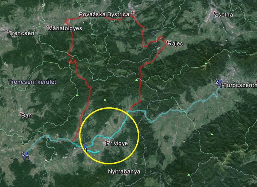

We’ve reproduced the issue we faced earlier with the following details:
The 3 points involved in this case are all in Slovakia:
The truck paramethers are the following:
RoutingParameter.ENABLE_ROADEDITOR = "true"
RoutingParameter.ROADEDITOR_LAYERNAME = "TruckAttributes_EUR_2014_2H"
RoutingParameter.ROADEDITOR_ADDITIONAL_OPTIONS = "MAX_WEIGHT=40000"
What we still can not undestand is fairly simple:
As long as we use only the start and end location points, we get the RED route as the planning result (you can see it on the picture I attached). But after we place the third point between the start and end locations we get the ligh blue route instead.
Our question is that if we can use these road segments on the light blue route circuled with yellow during the planning with 3 points, why can’t we use them during the original 2 points planning? The conditions are exactly the same during the 2 planning, it’s only the 3rd point which makes the difference as it seems.
