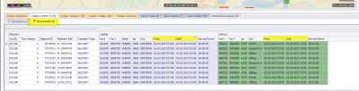

I have several unscheduled orders and the tour/vehicle time window have non-used time.
In the plan result, the vehicle ends at 12:45 even having availability to work until the next day at 1:00. As result I have unscheduled stops that should be scheduled since their time window is until 17:00.

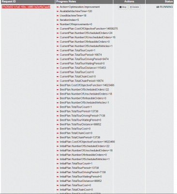

As an attempt to achieve better results, I have used the Improvement Step and also tried to adjust the Goals:
But, unfortunately the results are the same.

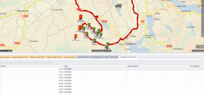

Under the plan result "unscheduledOrderAnalysisResults" I see the status "0 FEASIBLE" and none "Violation". So, it is suggeted to enable the improvement step but is already enabled. I'm having some difficulty to analyse what is wrong here.
I have attached some images to better describe this issue.

When orders are returned in the analysis as feasible, it usually is a sign that our algorithm was stopped because the available machine time was reached. I would advise to increase this value. It is found in the planning parameters. According to your screenshot it is now set to 2 minutes. Try to have it run without a available machine time and see if this improves the result.

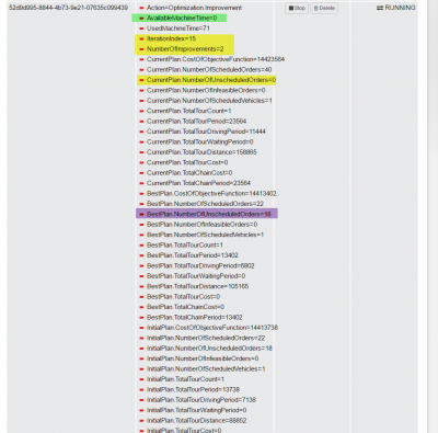

What is funny is that in the request I can see the CurrentPlan.NumberOfUnscheduledOrders reducing until reach 0. But, this is than different from what is returned in the plan.result where I than have 9 orders Unscheduled (18 transp. points).
It seems to me that as a result I receive the BestPlan where I see CurrentPlan.NumberOfUnscheduledOrders = 18
Please have a look to the attached image.
