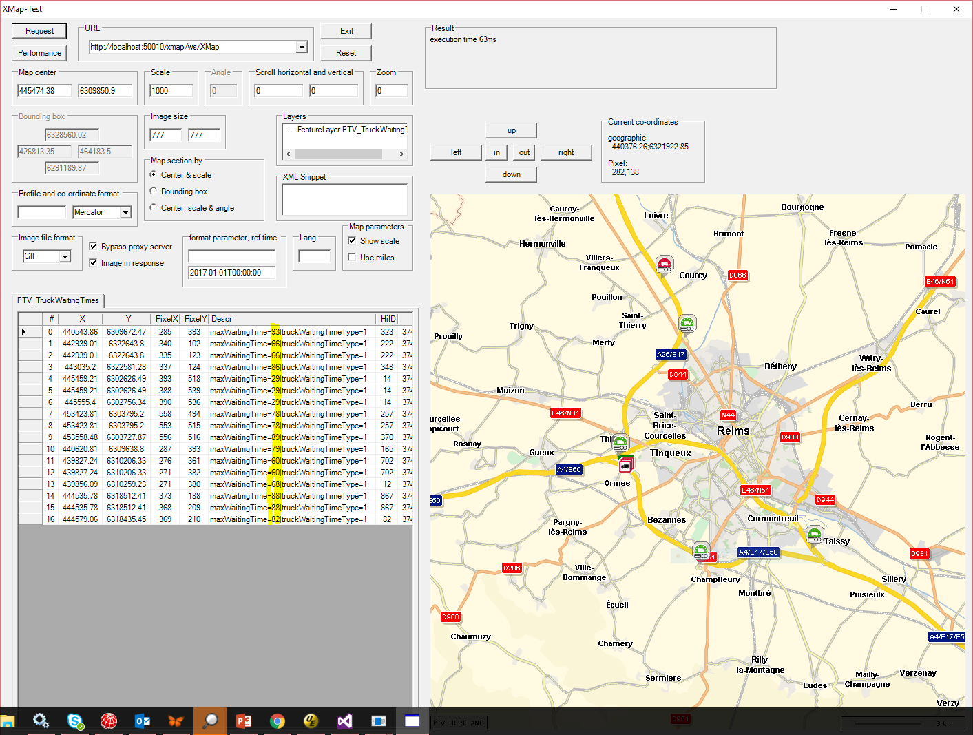

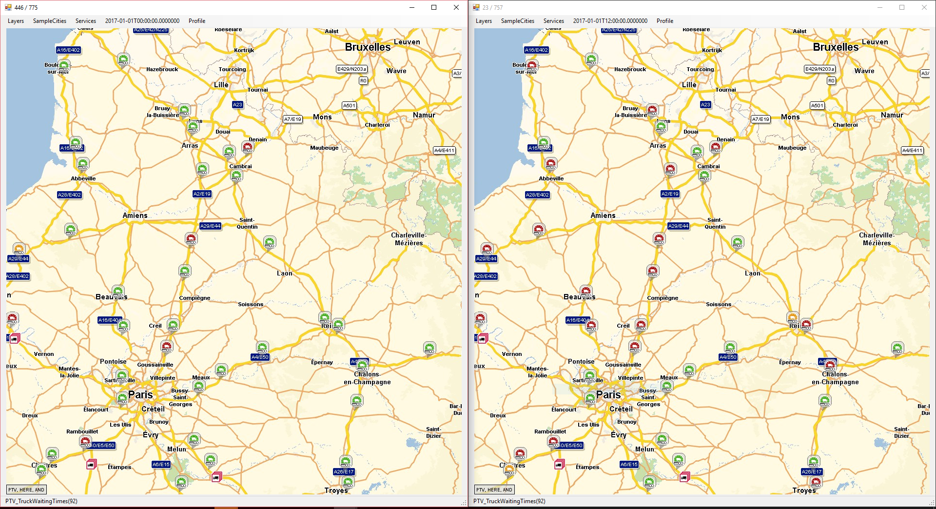

Here we go: another interesting feature layer: PTV_TruckWaitingTimes shows the statistical waiting times for trucks at specific gates. The info is daytime dependent, therefore I generated two comparison maps.
Feedback is welcome,
New FeatureLayer available: PTV_TruckWaitingTimes

Re: New FeatureLayer available: PTV_TruckWaitingTimes
Gooood morning MisterX,
the screenshots have been made with xServer1 and one of my generic tools. So the new Feature Layer works with xServer1 and with xServer2.
About the content: as with most data the question about the coverage is a very important one (you know what I refer to
For now I know that this layer is available for the two european maps 2017.1T and 2017.1H.
I'll redirect your question to the data experts when I'm in the office
C u,
