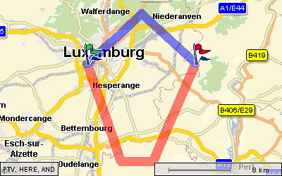

it depends on the potential moves whether such a constraint is meaningful or not. Imagine moves such as
  • replace scheduled order 123 by unscheduled orders 456 and 789 to achieve higher number of orders but reduced distances
northern track: input tour. tour is too long to add one of the other two southern point.<br />southern track: output tour. By removing the northern point it is possible to add two southern points
