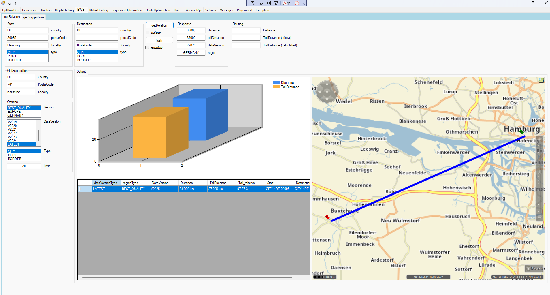

just received some similar request these days. The static data approach is still an option, but in the meantime we added a dedicated API into our PTV Developer suite which sounds like it could match the usecase of "support a tender process by offering standard distances":
EWS Road Distance API
It is based on two core functions
  • Suggest potential reference addresses based on cities, ports or borders. The total reference objects database contains 14'000 objects all over Europe and more than 10'000 just in Germany. The suggestion then returns complete foreign keys for referencing the locations in the second step. Coordinates are not contained at that level
    • Request:
        "country": "DE",   "locality": "Karlsruhe",   "postalCode": "76131",
        "region": "BEST_QUALITY",  "dataVersion": "LATEST",  "type": "CITY",  "limit": 10
    • Response:
        "suggestions": [
          {      "type": "CITY",      "country": "DE",      "postalCode": "76131",      "locality": "Karlsruhe"    },
          {      "type": "CITY",      "country": "DE",      "postalCode": "76133",      "locality": "Karlsruhe"    },
  • Ask for the reference values from start reference object to destination reference object.
    • Code: Select all
        "requestLocationStart": {
          "type": "CITY",
          "country": "DE",
          "postalCode": "20095",
          "locality": "Hamburg"
        "requestLocationDestination": {
          "type": "CITY",
          "country": "DE",
          "postalCode": "",
          "locality": "Buxtehude"
        "results": [
          "COORDINATES",
          "TOLL_DISTANCE"
    • Response:
        "distance": 38000,
        "tollDistance": 37000,
        "start": {    "type": "CITY",    "country": "DE",    "postalCode": "20095",    "locality": "Hamburg",    "latitude": 53.54897,    "longitude": 9.99337  },
        "destination": {    "type": "CITY",    "country": "DE",    "postalCode": "21614",    "locality": "Buxtehude",    "latitude": 53.46758,    "longitude": 9.68122  },
        "dataVersion": "V2025",
        "region": "GERMANY"
Sample user interface based on PTV Developer
