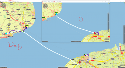

I have the same issue as Max: when routing between Calais and Dover (50.968637698, 1.873768495; 51.131455905, 1.3286909207), the GB-FR direction is all good (it uses the ferry), however the opposite direction (FR-GB) uses the Euro tunnel, and I cannot force to use the ferry in this case too. To tell the truth, I was not able to make the routing use the ferry instead of the Euro tunnel in any cases, when tried to relocate the FR coordinates.
Currently, we are looking for a solution where we can use only coordinates (and not FerryIds) for routing requests. Do you have an idea what is the issue here? Does the opposite direction have different parameters (eg. cost) that would make prefer the tunnel?

Re: Block Ferrys
Posted: Wed Apr 17, 2019 3:35 pm
Hello Daniel,
maybe the following description helps:
Among other approaches the motivation for a different track could be
- block elements on the unwanted route (define penalties AKA malus)
- make elements of the desired route more attractive (reduce their costs)
I created a simple routing from FR to GB using your coordinates and it took the tunnel.
By setting the OPTIMIZATION to an extreme value of "0" I encountered the change of the route:
- Looks like the way through the tunnel produces some additional kilometers but the additional way saves "time".
Let's have a look at the tunnel's own values (period, to be more precise):
"Calais - Dover" requires about 7140 seconds (about 120mins)
"the Tunnel" requires 5400 seconds (=90min)
I then played with optimization:
in my environment the behaviour switches between 73% and 75%.
I recommend that we have a 1:1 session to discuss how to approach this.
