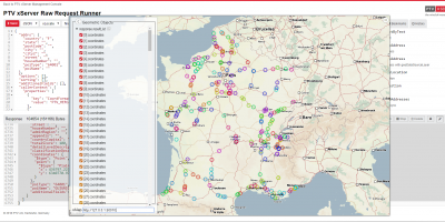

sample output for the request
  "addrs": {
    "country": "F",
    "state": "",
    "postCode": "",
    "city": "",
    "city2": "",
    "street": "",
    "houseNumber": "",
    "poiType": "64001",
    "poiName": ""
  "options": [],
  "sorting": [],
  "additionalFields": [],
  "callerContext": {
    "properties": [
        "key": "CoordFormat",
        "value": "PTV_MERCATOR"
        "key": "Profile",
        "value": "default"
