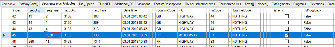

you can retrieve the time from the ferry segment:
List of segments. A ferry segment does not provide a segment length but period. This example is DOVER-&gt;CALAIS which is about 2 hours.
List of segments. A ferry segment does not provide a segment length but period. This example is DOVER->CALAIS which is about 2 hours.

(maybe) one (little) thing:
Where can I get segTime?
- Currently I only get accTime.
Or is "your" segTime = accTime (y) - acctime (x)?
Thanks in advance
Max
Max Beermann
Development Manager
WHEELS Logistics
Posts: 2967
Re: Ferry-Costs
correct: it is derived by some other properties:
if (SegmentIndex==0)
 segTime = segment[0].accTime;
else
 segTime = segment[segmentIndex].accTime - segment[segmentIndex-1].accTime;
