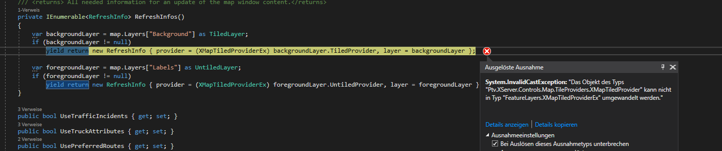

Re: Feature Layer
Hallo Oliver,
leider konnte das Problem mit Komponentenupdate und Verwendung des neuen Feature-Layer Beispiels nicht behoben werden.
Die Fehlermeldung bleibt gleich. Ich habe ein Testprojekt hierzu hinzugefügt, damit Sie das Problem sehen könne.

- Oliver Heilig
- Posts: 160
Re: Feature Layer
Hello Frank,
i've reviewed the sample and found the problem is that you must initialize the map with specific providers, and not just by setting xMapUrl.
I must admit this is a bit cumbersome, but was required because the default didn't support the ReferenceTime property, which is required for FeatureLayer. I've added this property to the basic xmap-1 provider. Now the special implementation isn't needed, and you can change ReferenceTime with the standard inplementation. Take a look at the new sample.

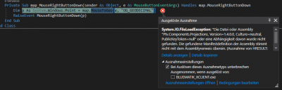

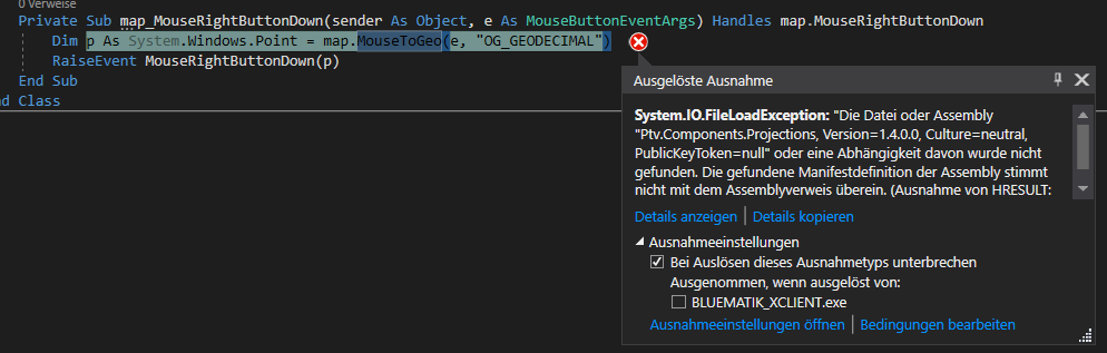

But i have found another issue. The Function of Map MouseToGeo now raises an error caused by Ptv.Components.Projections. Please find attached the Screenshot. I think i need the latest Projection Component too. Can you help me with that.
BR
Frank

- Oliver Heilig
- Posts: 160
Re: Feature Layer
Hi Franke,
if you are using the transform functions with a specific coordinate system, you need to make sure you have the Ptv.Components.Projections.dll. But if you are just using standard WGS84 coordinates, you can also omit the parameter, because this is the standard format of the control.
https://github.com/ptv-logistics/xserve ... ips.cs#L39
My recommendation is to always use WGS84 (x=lng,y=lat) coordinates in you project, so
[*] Omit the coordinate format for the map control, the default is WGS
[*] For xServer-1 requests use "OG_GEODECIMAL" to use WGS
[*] For xServer-2 requests, omit the, the default is WGS
