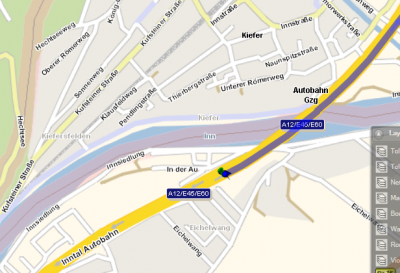

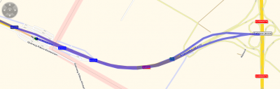

I think the cause for the behaviour is the proximity of your waypoints to the borders of adjacent countries: the coordinates are located at highways where you'd have to follow the road, cross the border and perform a major turning manoeuvre in the neighbour country.
See the attached images.
- 1st Waypoint: located near the german border
- 2nd Waypoint: located near the slowak border
In other words: depending on the coordinates close to highways you need to drive into the "forbidden" zone.
What I'm surprised of: that xRoute claims to resolve this. By the way: not sure whether you face "linking" issues. I assume it is a "routing" issue after a successful linking.
