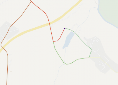

Re: calculateBulkRouteInfo vs calculateRoute
Faced something similar with a custromer today.
The problem has dissapeared after I
- disabled leveling (set the scopes to -1 for all NCs)
- did set the ViaType of the inner stops to VIA_STOP
example: the red route approaches the waypoint, turns over there and therefore follows the path where it came from.<br />The green route passes the waypoint without turning. This is a part of a longer route and caused a differenfe of more than 2 kilometers.
