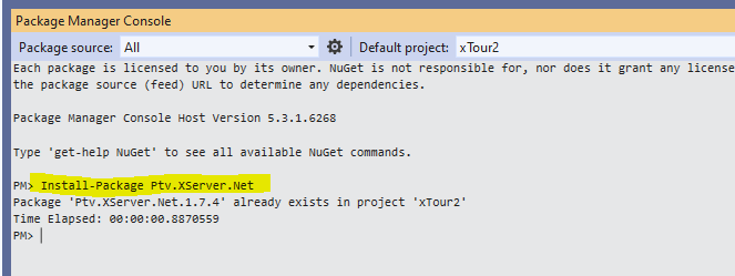

and my highlight: use the Visual Studio NuGet Package Manager:
Install-Package Ptv.XServer.Net
This will update your local installation of the form ;-)

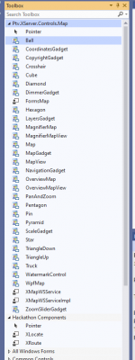

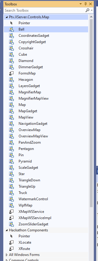

Best case: the formsMap element appears in your toolbox.
If the formsMap control does not appear in the toolbox though it was imported properly perform
- right click on tools section
- follow "choose items"
- browse to the path of the controls DLL
- add it
