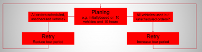

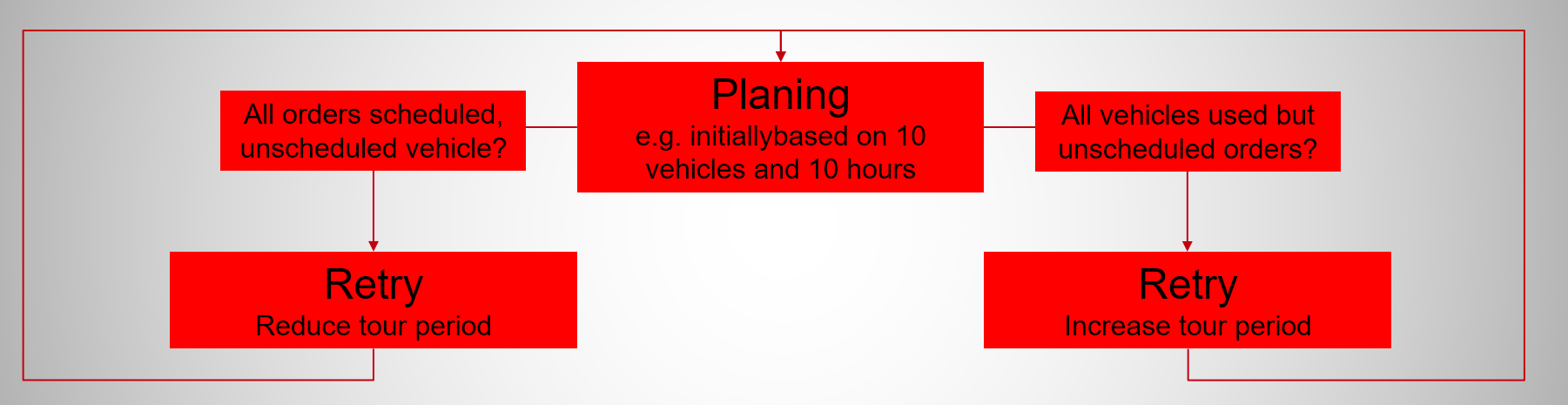

Here's some little brain teaser for the story...
Some alternative representation of the approach

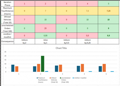

The setting for this ficticious example is based on
  • 100 orders
  • 10 vehicles
Now here are the changes through the iterations where I play with the maximum tour distance:
  • Initial result based on 9 hours:
    • Only 7 vehicles used: BAD
    • all orders scheduled: good
    • ratio between shortest (0 km) and longest tour): 0 = BAD
    • Consecquence: reduce max tour period
  • Iteration 2 : maximum tour period set to 7 hours
    • All vehicles scheduled : good
    • not all orders scheduled: BAD
    • Ratio : 0.95 : good
    • consequence: relax
  • Iteration 3 : maximum tour period set to 8 hours
    • not all vehicles used: BAD
    • ratio : bad
    • consequence: reduce
  • Iteration 4 : maximum tour period set to 7.5 hours
    • all vehicles scheduled : good
    • ratio : still not sufficient
  • Iteration 5 : maximum tour period set to 7.25 hours
    • ratio within desired range
    • consequence: DONE
