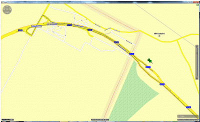

I face an interesting problem that I can't solve on my own:
As you can see on the attached picture I have a defined waypoint next to a border (green flag) , and the NEXT_SEGMENT or AUTO_LINKING links that point to the START position. The problem comes from that new position because it's in a different country which is excluded during the planning. As a result PTV can not plan that route.
The easy solution could come from the heading values but they are not defined in that case. My first idea was to increase the search range for the matching, but it had no effect. As I see PTV doesn't try to find a new waypoint after he find 1 which is valid, even if he can't plan a route with it. Is that correct?
Do you have any suggestions how can the matched point be placed in the same country as the original point?
Thank you,
K.Zsolt

				Hello K.Zsolt,
your request is really special - due to the constraint of the border coordinates.
I forwarded your question to some developers but to be honest: I expect this problem can't be resolved that easy.
If the task is a conflict similar to "compute a route from one island to another but don't use ferries" it is not possible to find a generic solution. But let's wait for the devlopers response.

Actually it's not really similar to "compute a route from one island to another but don't use ferries" problem in my opinion. Instead I need to limit the waypoint linking somehow only to work in the country I define in the original point. So the matched point doesn't "move" to the other country and the planning will work. I'm not sure if there is any way to achieve that without using angle parameters, but hopefully you can suggest something.
K. Zsolt

meanwhile I received the following answer from the core developer:
Yes you are right: during the linking step we do not consider the parameters allowedCountries and forbiddenCountries.
This is because we can't decide what kind of routing is expected under such conditions.
But: even if the linker chooses the segment in the "allowed" country: this would lead straight to the border which one you are not allowed to cross. So from our perspective this challenge can't be resolved by design.
We might replay this specific example based on your coordinates but I expect that "start segment is forbidden" is simply replaced by "can't find a valid route".
Sorry for this negative feedback,
unfortunately this is the current approach of our engine.
Worst case you have to identify a better starting point manually.
Best regards from Germany,

Yes sadly I was almost sure that this will be the final case
Anyway, thanks for your help! I'll try to find a workaround.
Zsolt
