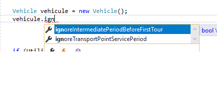

in the documentation I saw BaseVehicle.ignoreProductIncompatibilities
http://xserver.ptvgroup.com/fileadmin/f ... aseVehicle
but this option it's not present in the SOAP interface (xTour 1.22.0.1).
where am I wrong ?
Thank you

Hello Michel,
the feature "ignoreProductIncompatibilities" has been invented with xTour 1.26.0.0:
Feature: The consideration of product incompatibilities can be switched off for specific vehicles by using the new attribute 'ignoreProductIncompatibilities'.
So if you want to benefit from this parameter please update to 1.26. I expect a minor update being released in the next two weeks. So maybe you could wait for that next version.

I suspected it !
it's OK
Thank you Bernd
