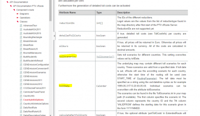

Hello Vlad,
a specific set of tarifs for a given country with it's period of validity is called a scenario and the available scenarios are meta-defined in the TollScenarios.INI in the map root folder. Check this post:
https://xserver.ptvgroup.com/forum/view ... ?f=7&t=859
Maybe one remark: the list of scenarios is not replaced but extended.
If you prefer to reference a specific scenario during a routing call use the CountryInfoOptions: You can either set the toll date (past, present or future) or specify a list of explicit scenario codes.
Does this answer your questions?
