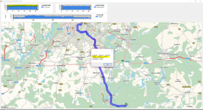

- Overview of a testclient that calculates the same waypointlist at 00:00, 01:00, 02:00.... and returns the diagrams that show the difference of some KPI. Looks like your route has always the same geometry but takes between 48:58 and 52:35 minutes.
Looks like the gap isn't that big in the data.
If you wish to have a 1:1 websession get backto me so we can have a look at this scenario together (and at some more tools).

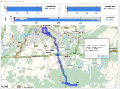

- HERE map produces distances between 57.92 and 61.03km (5.37% difference) and 1:06:03 and 1:13:16 (10.93%)

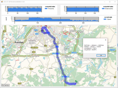

- TOMTOM map returns between 56.76 and 60.98 km (7.45%) and between 0:50:28 and 1:03:56 (26,68%)
| Provider | min period | max period | min distance | max distance |
| TOMTOM | 0:50:25 | 1:03:56 (+26.68%) | 56,76 km | 60,98 km (+7.45%) |
| HERE / TLN | 1:06:03 | 1:13:16 (+10.93%) | 57.92 km | 61.03 km (+5.37%) |
