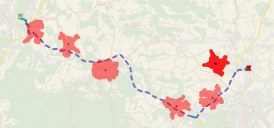

As of today the implementation of xRoute 2 does not yet offer the corridor search but there's also another approach to perform the routing based fencing - a least as a temporary solution if the corridor is small:
- Compute the
reacheable area(aka Isochrone) around the latest GPS coordinate
- Check via geometry functions whether polygon and isochrine intersect
- several position's isochrones have been checked against the route...
But I am very optimistic that we will implement and proivide a corridor search in the xServer 2

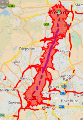

Just have been asked for this again in 2024:
They would like to plan a route for a vehicle and take into consideration truck attributes on the route with the height width as well as allowed driver hours into consideration. Once the route is planned, they would like to post/send that specific route to navigator, and then generate alerts once the driver goes off route in their platform.
Here’s my feedback, based on PTV xServer2 (please let’s always mention the API version):
- What’s the exact definition of “the driver goes off route”? E.g. requires more than 10min to return to the route
Here’s the xroute2 contribution – someone from the navigator domain would have to comment on “
how does the mobile device push it’s coordinates to the backend?”.
Technical limitations:
- Maximum route length = 500km (total route could be split in chunks based on partial trips given by the Break and Rest events)
- Such fencing is not the same as “he won’t be in time” as it only checks inside/outside but not “in time”
Example:
- 10min fence on the path from Pretoria to Johannesburg
- Route from Pretoria to Johannesburg - fence 10min
