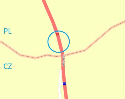

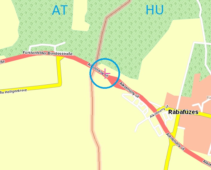

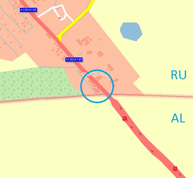

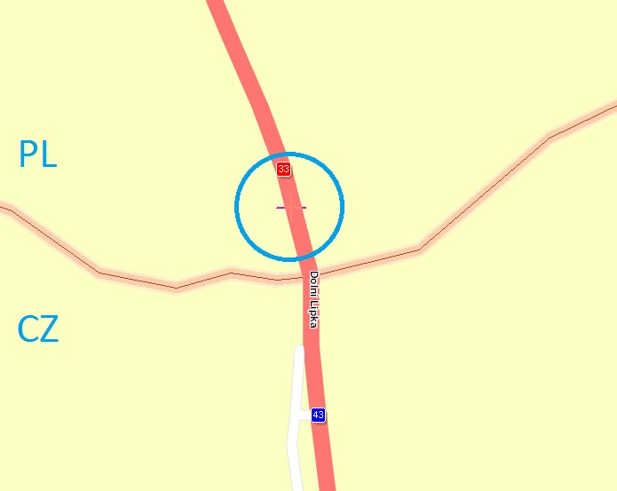

For example:
1) 46.984421,16.277086: According to PTV that point is in AT, but its in HU actually.
2) 50.096939,16.704661: According to PTV that point is in CZ, but its in PL actually.
3) 54.372202,20.659414: According to PTV that point is in AL, but its in RU actually.
and so on.
What can cause that issue and how can we fix this? I've attached 3 pictures which represent the 3 points I've posted as example.

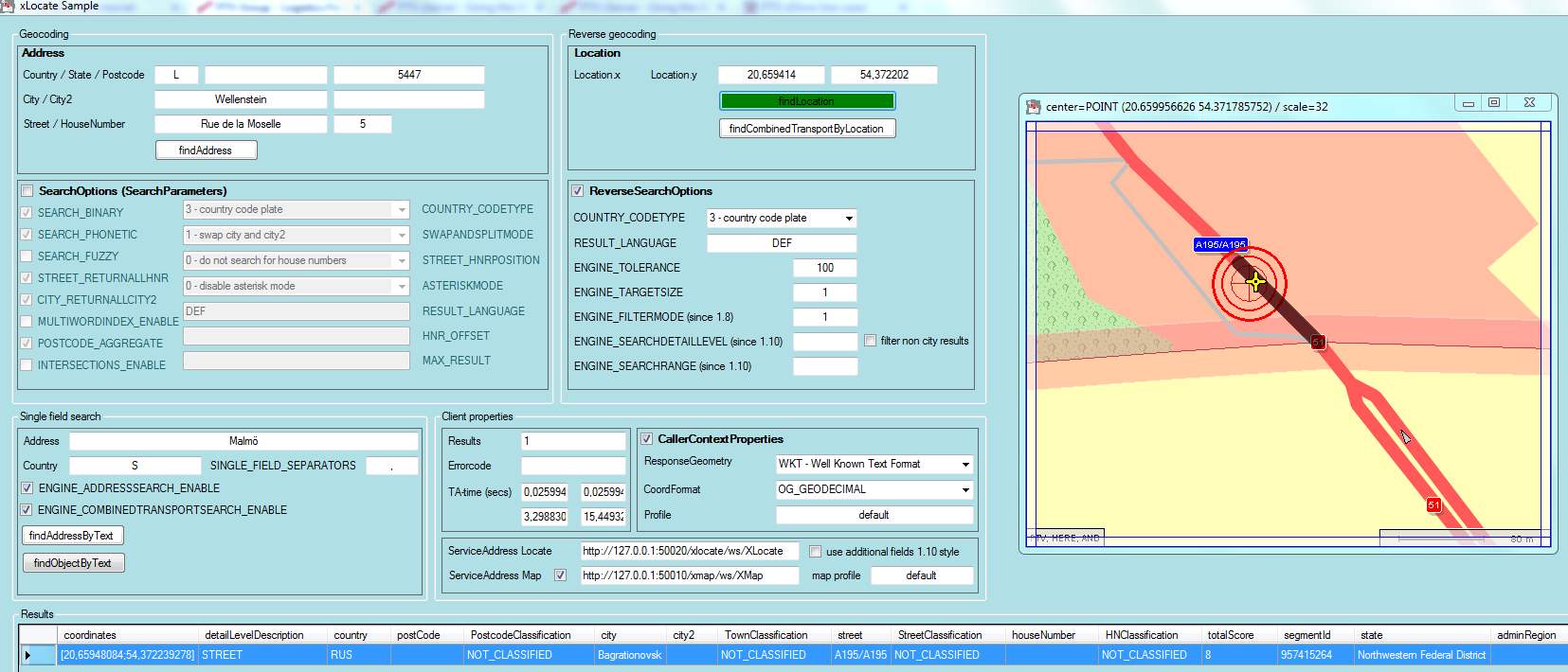

What can be the case is that you are using Reverse search options to filter out unnamed streets. From:
http://xserver.ptvgroup.com/fileadmin/f ... s%7C_____7
ENGINE_FILTERMODE None
Specifies the way how xLocate will filter the reverse locating results. Possible values:
0 - filters nothing
1 - filters results where the street has no name
2 - filters streets without a name and duplicate street results.
Normally a value of 1 is desirable because most matches on unnamed streets are often wrong matches due to GPS drift. For example small dirt road that run parallel to a high way.
I did try to reproduce your last example but wasn't able to. I would recommend to check you options. It is also possible that I'm using a newer map (tested on 2014.2T and 2014.2H).

I made similar tests as Joost with
xLocate + PTV_Europe_City_Map_Premium_2014_1T
By using findLocation my results were proper.
Additional tests with xRoute.calculateRoute were also succesful. Regards Bernd

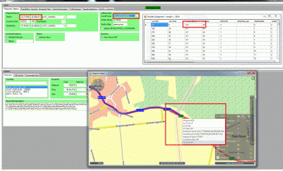

Re: Problematic waypoints next to borders
Hi!
When I run the tests in the client that Bernd sent me I recieve the right country codes just like you guys, but for some reason when I try to validate my waypoint from code with a CalculateRoute method calling (to plan a route between that problematic waypoint and a different one which is defined), the iuCode property gets set to the wrong (43 instead of 36) value.
Thanks,
Kiraly Zsolt
Thanks,
Kiraly Zsolt
