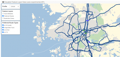

The followiong screenshot was made with the Showcase:
PreferredRoutes in the Gothenburg region

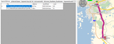

And here's a screenshot from my local client
Sample route considers PTV_PreferredRoutes. I aggregated the segments via segment.segmentAttributes. As you can see almost the whole route is based on BK1, the rest is BK_2.

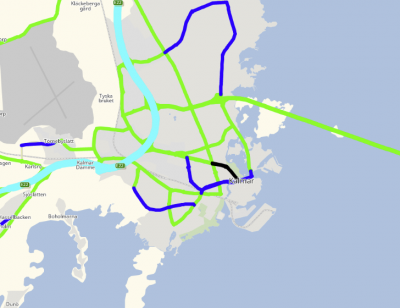

It is indeed possible to represent with different colors the different BK types. See for instance the attached request.
* BK1 in green<br />* BK2 in blue<br />* BK3 in black<br />* BK4 in cyan
* BK1 in green
* BK2 in blue
* BK3 in black
* BK4 in cyan

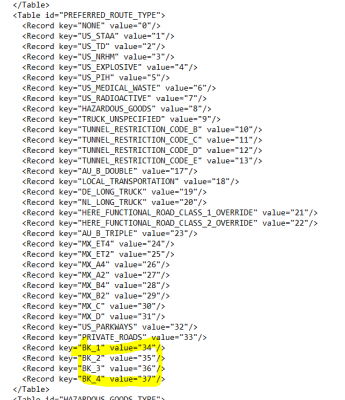

Unfortunately the rendering profiles do not expect these labels such as BK_1 but specific integers and of course the next question is: where to find the matching between such a label and the integer?
Technically spoken the definition of these values is given in the so-called property connector files within the map. Here's an example from my local installation:
Excerpt from my local propertyConnectorV014.xml (in the map folder)
:!: I can't guarantee that the integer values are stable - they might change from map version to map version!
