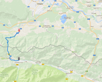

Example 2:
The road from Podkoren (Slovenia) to Tschau (Austria). The road is blocked for vehicles with a trailer. Once again, when using the PTV Map&Guide the restriction is considered and the calculated route goes around it, but when I call the operation, the restriction is once again not considered and the calculated route goes on the restricted road.
The XML request is basically the same, except for the WaypointDesc:
I am including the PTV_TruckAttributes and PTV_RestrictionZones layers through ProfileXMLSnippet in the CallerContext property.
