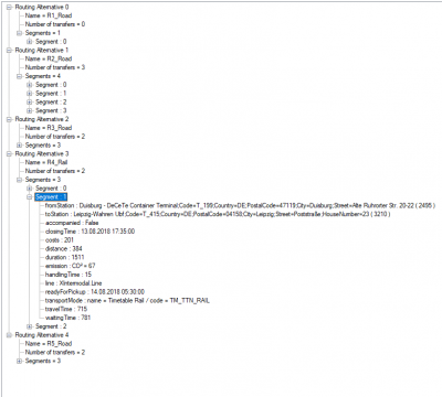

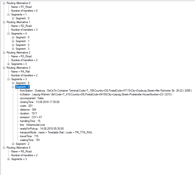

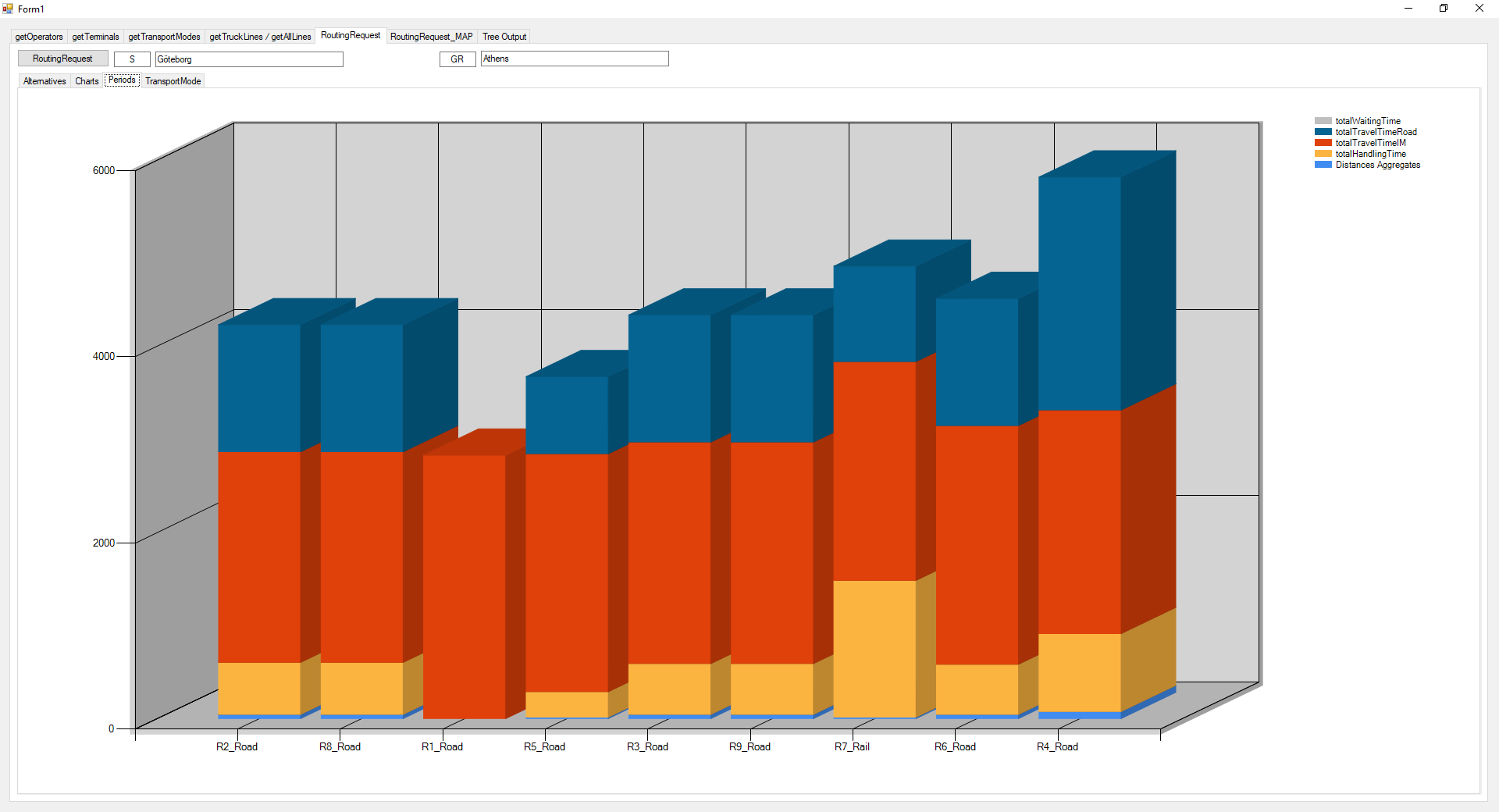

for each alternative I get several KPIs...
and for some of the segments I get shortscuts of how to get from one hop to another one... those sections can use various transport modes such as street, rail, ferry... even considering the timetables (if configured and properly feed)

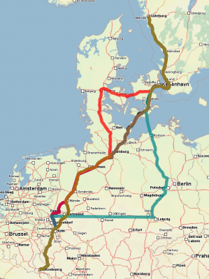

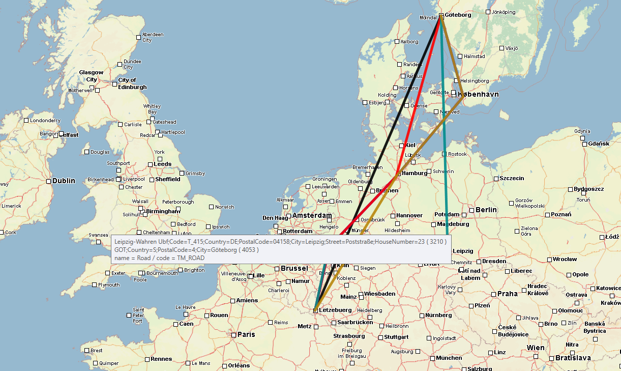

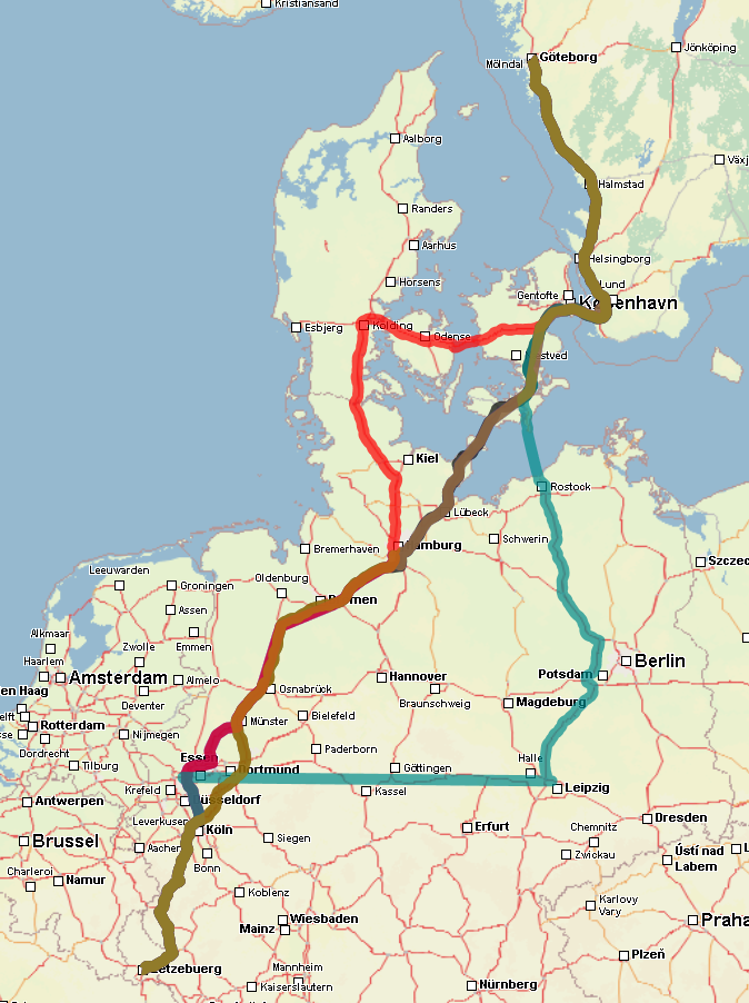

I can then visualize the segments in a map as well...

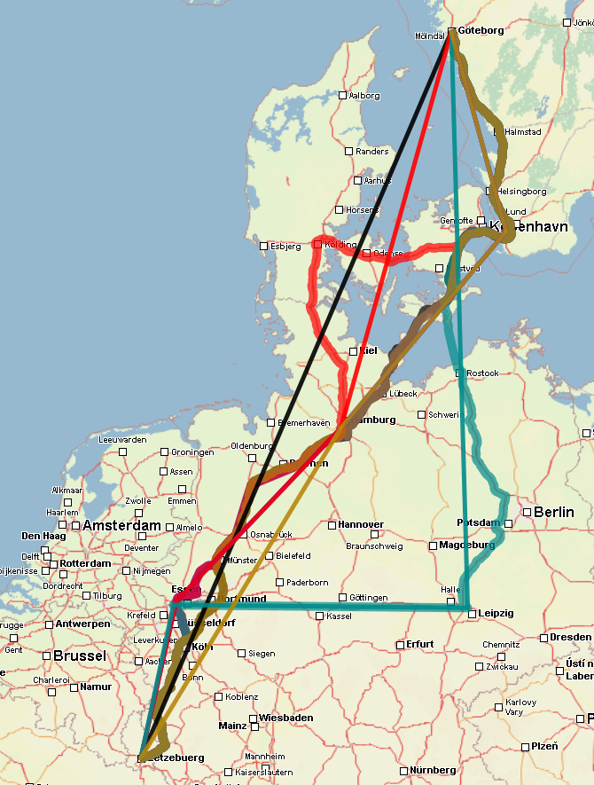

even together with the alternatives themselves

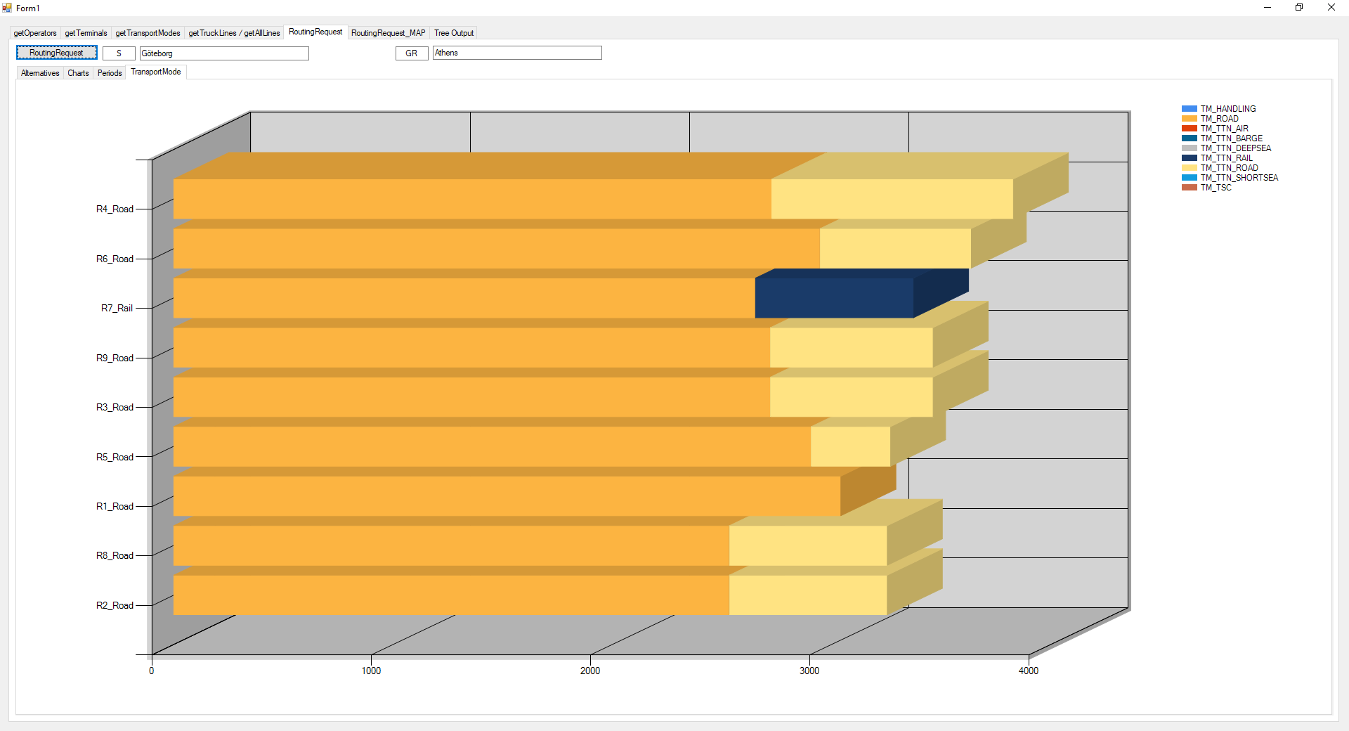

Periods spent on the various time modes

Periods spent on the transport modes
