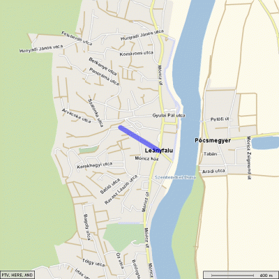

When entering a postcode and a corresponding location name in the Address field of xLocate and using the findAddressByText function, we are facing a problem as detailed below.
By entering a postcode (e.g., HU, 2016; 47.717614331, 19.083980869), we get a different result (coordinates) compared to when entering the name of the town (e.g., HU, Leányfalu; 47.715635484, 19.088868487) if the location has only one postcode. It seems that in one case the result is put on the name of the location displayed on the map, while in the other case the result tends to the geometric midpoint of the town. In some instances, it can result in quite big distances (even more than 1 km). Currently, we are using xLocate version 1.24.0.0 and PTV_Europe_City_Map_Premium_2017_1H_12.
We understand that it is a proper way of functioning to get different results when a city has more than one postcode. But if a town has only one ZIP code, it seems reasonable to get the same results. Does this way of displaying data have a specific reason? Is it possible to set the exact same location (coordinates) for one postcode and the corresponding location name?
Thank you for your reply in advance!
Kind regards,
Daniel

you are right. I forwarded this topic to our experts and asked for a feedback. The gap is >0 but not completely far off.
Two different results coordinates based on postcode or city input...
Let's wait for their reponse.

The reason is the name of a city is a point (City Center POI) tha we are getting from the data provider. The postal code is an area so we have to calculate the point by ourselve. Both point are also different on Here WeGo.
Searching only for the postal code 2016:
https://wego.here.com/directions/mix//2 ... ,15,normal
Seraching only for the city name Leányfalu:
https://wego.here.com/ungarn/le%C3%A1ny ... 3%A1nyfalu
