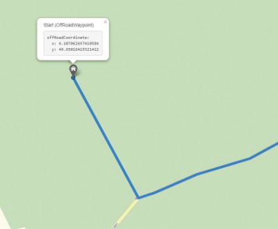

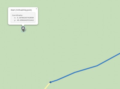

I do no thick that the fact your coordinate is Off Road is the issue. Coordinates in practice will never be exactly on a road especially if they are coming from a GPS device. Our engine will always try to link to the nearest road found up to 50 km away (configured in the RouteRequest -> requestProfile -> routingProfile -> linking -> maximumDistanceToSegment if you want to use other values).
The difference between OnRoadRouteLocation and OffRoadRouteLocation is NOT if linking the point to a network will succeed, but if the distance from the coordinate to the network should be counted toward the route or not. See the difference in the screenshots.
I'm not sure what is causing your routing to fail, my best guess is that you are dealing with delivery areas but that would still be a guess. If you can send a sample of a complete request we can check this deeper.
