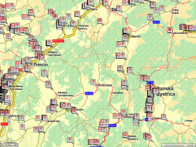

Look at this screenshot:
- country roads
As you can see the routing track uses some trunk roads that are located at about 50km from the start - tehy might be unavailable in the data setting you use...
- the map
Maybe this is the cause for the issue?

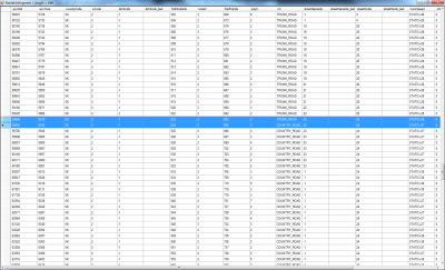

I computed the default track incl. TruckAttributes data but without vehicle dimensions:
Some segments have special attributes:
<ns3:segmentAttr isPiggyback="false" lowEmissionZoneType="0" additionalRE="MAX_WEIGHT|1=14000" isPedestrianZone="false" hasSeparator="false" hasExtraToll="false" hasVignetteTruck="false" hasVignetteCar="false" hasTollTruck="true" hasTollCar="false" isBlockedTruck="false" isBlockedCar="false" isFerry="false" brunnelCode="NOTHING"></ns3:segmentAttr>
<ns3:segmentAttr isPiggyback="false" lowEmissionZoneType="0" additionalRE="MAX_WEIGHT|1=22000" isPedestrianZone="false" hasSeparator="false" hasExtraToll="false" hasVignetteTruck="false" hasVignetteCar="false" hasTollTruck="false" hasTollCar="false" isBlockedTruck="false" isBlockedCar="false" isFerry="false" brunnelCode="NOTHING"></ns3:segmentAttr>
<ns3:segmentAttr isPiggyback="false" lowEmissionZoneType="0" additionalRE="MAX_WEIGHT|1=18000" isPedestrianZone="false" hasSeparator="false" hasExtraToll="false" hasVignetteTruck="false" hasVignetteCar="false" hasTollTruck="false" hasTollCar="false" isBlockedTruck="false" isBlockedCar="false" isFerry="false" brunnelCode="NOTHING"></ns3:segmentAttr>
So if the used vehicle has more than a specific weight the routing will perform detours.

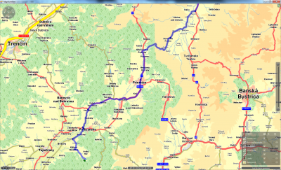

What we still can not undestand is fairly simple:
As long as we use only the start and end location points, we get the RED route as the planning result (you can see it on the picture I attached). But after we place the third point between the start and end locations we get the ligh blue route instead.
Our question is that if we can use these road segments on the light blue route circuled with yellow during the planning with 3 points, why can’t we use them during the original 2 points planning? The conditions are exactly the same during the 2 planning, it’s only the 3rd point which makes the difference as it seems.

Posted: Wed Oct 08, 2014 1:29 pm
by KZsolt
Dear Mr. Brend Welter,
With a routing profile modification We've managed to solve the issue we faced.
Thank you for the help!
