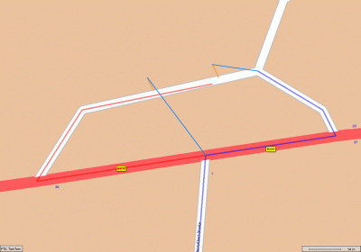

Re: Waypoints on specific street being ignored
Posted: Fri Aug 18, 2017 11:39 am
From my understanding you should look at the linking types.
- Orange = AUTO_LINKING,
Blue = NEXT_NODE
The sample request uses NEXT_NODE and the NEXT_NODE is located on the national road B208.
I assume the AUTO_LINKING provides the result you want: your input coordinates are matched via the orange line.
Right?
