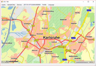

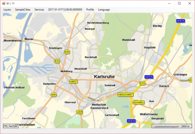

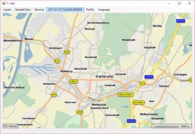

- Default profile
- Sandbox profile
- Silkysand profile
