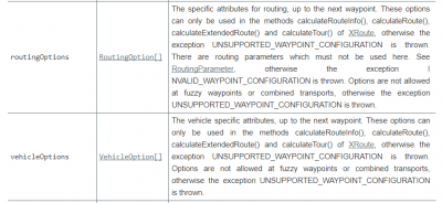

I recommend to check the following properties of the WaypointDesc class:
  • routingOptions
  • vehicleOptions
Their purpose is to define individual settings on parts of a track.
Two properties of the WaypointDesc class. They are applied between two stops then.
Looks like they are what you need for the usecase described above.
