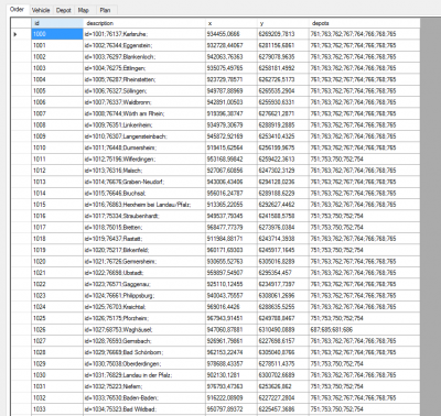

Getting back to this topic Clement and I are evaluating whether each service technician could be handeled as his own depot...
Technician 1 : Located at Depot 1, responsible for {76131, 76133, 76135,76138}
Technician 2 : Located at Depot 2, responsible for {76131, 76133}
Technician 3 : Located at Depot 3, responsible for {76131, 76135}
Then we determine for each order "who are the service technicians that are allowed to serve him" (SQL query).
e.g.
Customer 666 is located in the postcode area 76131 and therefore can be handeled by Technician 1,2,3: depotIds={1,2,3}
Customer 777 is located in the postcode area 76133 and therefore can be handeled by Technician 1,2: depotIds={1,2}
How about this? From my perspective this models the usecase and there is no limit in the API dealing with "maximum number of depots".
Any doubts? Counter-arguments?
Regards Bernd

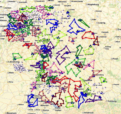

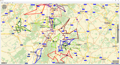

We approached this via the depots now:
Each ServiceTechnician is modelled as his own depot and then we specify a list of potential depots that could serve customer xy.
- Codesamplescreen
Looks promising - have to check this with bigger values...
- Each order is served by one or more depots (=service technicians).
- Looks good...!
