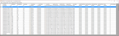

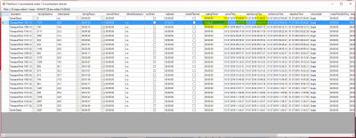

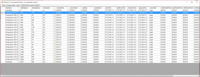

Hi guys,
you could also use startTimeFixed without an input plan. Here are some examples with same restrictions
- 20 orders of 5minutes
- 07:00 - 17:00 operating interval
- 09:00 - 18:00 opening interval
just the startTime is different:
- StartTime not set. Tour starts 08:55, first customer is visited at 09:00.
- StartTime set to 11:00. Tour start at depot is 11:00. First customer to be visited: 11:00
- Start time set to 07:00. Tour starts early, arrival time at customer produces waiting time because opening is at 09:00.
