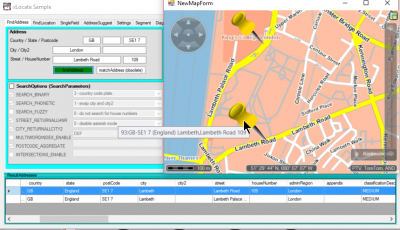

I'd like to look up "109 Lambeth Road, SE1 7LP, London, GB" with method findAddress:

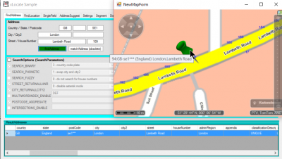

With post code "SE1" or less, I'll get only street (reference point), but by omitting house number and setting post code to "SE1 7" or more, I'll get the list with all available house numbers

we were using this url of the PTV World City Map (TOMTOM):
https://api.cloud.ptvgroup.com/xlocate/ws/XLocate

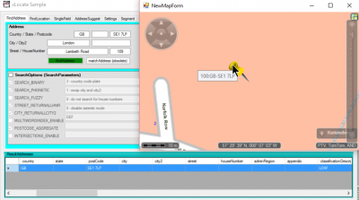

- Input pattern: Full postcode. The result is based on the extended zipcode data and contains a 7digit representative.
- Reduced input pattern based on leading 4 characters. Result is as it should be: contains concrete house number is found. That's what the user expects.
- By removing one more character (input pattern based on leading 3 chars) the result aggregates postcodes
Not sure whether the user simply needs an explanation for the 3digits behaviour or a parametrizing that is able to identify the housenumber even with 3 digits.

Now I know why the housenumber isn't found in the 3rd. case.
The housenumber "109 Lambeth Road" is assigned to the city Lambeth. If the input is "109 Lambeth Road, SE1 7, London, GB" the xLocate is finding the street directory with the postalcode and the city input. So both are considered to choose the result address.
If you are searching with the input "109 Lambeth Road, SE1, London, GB" the postalcode isn't complete, therefore it isn't taken into account to find a street directory and it also isn't considered to find the housenumber. The xLocate is finding a street segment "Lambeth Road, London, GB" which fits better to the input than "109 Lambeth Road, Lambeth". That's the reason why the xLocate is returning only the street section and not the housenumber.
