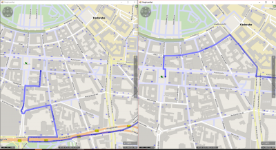

these days I was asked by a customer why his route drives straight through a pedestrian zone.
Besides some more or less regular attributes the routing profile contains the following part:
<Vehicle>
<Legal>
<LegalCondition isAuthorized="true" isDelivery="true" isEmergency="true"/>
</Legal>
</Vehicle>
By setting the flags for isDelivery==TRUE the vehicle is allowed to drive to / through such an area.
- LEFT: complex detour, furthermore the pyramid waypoint isn't reached. The real trip starts in a small distance from the pyramid.
RIGHT: the vehicle is allowed to use the delivery flag and therefore the linking attaches the route almost direct to the pyramid.
So for this customer we have to check whether he really wants the parameters like that.

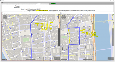

And here is an example for the isAuthorized flag:
- left track: isAuthorized==TRUE. Track leads straigth through the blocked road.
right track: isAuthorized==FALSE. Detour necessary because of the blocked road.
<VehicleSpecific>
<AuthorizedVehicles turningBanCost="0"/>
<DeliveryVehicles segmentMalus="0"/>
<EmergencyVehicles segmentMalus="0" turningBanCost="0"/>
<ProjectSpecificVehicles blockedSegmentMalus="2501" openSegmentMalus="0" turningBanCost="0"/>
</VehicleSpecific>
