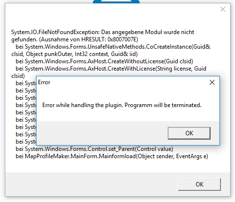

I got a link from Bernd for a tool to generate INI files with individual designs for maps.
In our case we want to create a design that looks like google.
But Tool doesn't start, it gives attached error message.

Error Message
Error Message

Hello Paul,
I'm sorry to say that MapProfileMaker is no longer supported. I can just give you the hint to check if all files have been correctly downloaded and extracted into a local folder. In a test this error occurred if the tool wasn't able to find PTVSTATICxVectorMap31.dll.
If that doesn't help one alternative might be to stick to one of the additional profiles shipped with PTV xMap Server (gravelpit, silkysand, sandbox) or to adopt one of these profiles using a plain text editor.
