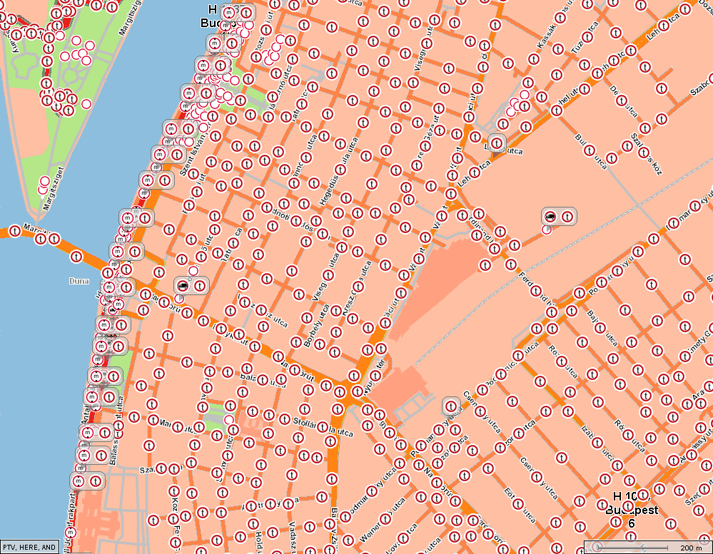

I made some tests with your profile and I get almost the same polygon structure when your constraints are activated.
- The "shortest" route in the western part of Budapest uses segments where certain restrictions apply. I can see them after enabling VIOLATIONS with COST=0.
- By activating both additional datasources (binary TruckAttributes + FeatureLayers) a large detour occurs.
- Only binary truckattributes activated: straight through the city.
So the next thing I did was to compare the datasources.
Looks like the FEATURE layers contain more data than the BINARY TRUCK ATTRIBUTES:
- Both FeatureLayer plus Binary...
- TruckAttributes only
- FeatureLayer only
If you want to consider the feature layers, too, you have to add this to the profile:
<GlobalSettings enableTimeDependency='True'/>
<Themes>
<Theme id='PTV_TruckAttributes' enabled='True' priorityLevel='0'/>
<Theme id='PTV_RestrictionZones' enabled='True' priorityLevel='0'/>
</Themes>
</FeatureLayer>
Does this help?
I can add further statistic reports to the testclient if needed.
Re: Routing through restricted area
Posted: Tue May 16, 2017 2:05 pm
Just spoke to a data department expert. The legal conditions of most of these additional attributes are time dependent.
The traditional binary road editor files contain only attributes which are enabled EVERYtime while feature layer based attributes contain both permanent and time dependent restrictions.
This is probably the cause for the behaviour experienced above.
