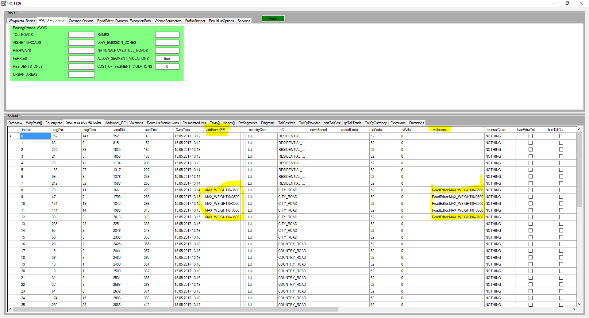

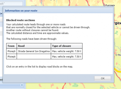

I assume you need to gather the segments that are returned similar to this message taken from MAP&GUIDE Internet:
- Message taken from MAP&GUIDE Internet
The term you are looking for is probably the
violation. Violations occur if a route uses segments with constraints (e.g. TruckAttributes) and the routing parameters allow such conflicts.

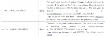

You can use the following parameters to request so-called "violation" information as part of the routing output:
- RoutingOption
- Explicit routing options
- Via snippet / profile:
<Profile>
<Course>
<Violations>
<SegmentBlockingViolations cost="50000" enabled="false"/>
</Violations>
</Course>
</Routing>
</Profile>
Depending on the additional COST value the server will ignore some constraints if it is cheaper (virtually spoken) to drive through the conflict instead of performing a detour.
- Sample route based on TruckAttributes violations. COST is set to 0. Routing takes regular track as without TruckAttributes but reports the conflicts.
- The violations are reported in the RouteListSegment list (right). The column AdditionalRE just mentions that there are soem additional constraints - whether they are violated or not.
