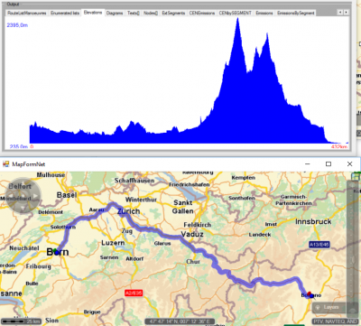

By the way: though we do not return the z-Coordinate as requested in the initial post we are able to provide the elevation profile of a route.
- Sample track from Bern (CH) to Bolzano (I)

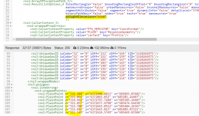

<ns2:ResultListOptions_4 totalRectangle="false" boundingRectanglesOffset="0" boundingRectanglesC="0"
tollManoeuvres="false" manoeuvreGroups="false" urbanManoeuvres="false" brunnelManoeuvres="false"
manoeuvreAttributes="false" segmentAttributes="false" segments="true" dynamicInfo="false"
detailLevel="STANDARD" polygon="true" binaryPathDesc="false" nodes="true" texts="true"
manoeuvres="true" polygonElevations="true"/>
You have to request both
polygon and
polygonElevations via the ResultListOptions. This will return the Z-coordinate in the polygon then.
- Sample screenshot showing the result list options requesting the z-coordinate in the response.
This also requires the file
heights.bin in the maps root folder.
Depending on the framweork you use for the GUI it is then a more or less big challenge to display the diagram.
