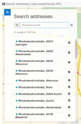

xServer 1 won't approach such an input pattern but xServer 2 will probably be able to help:
- Screenshot produced at internal version of xLocate 2

you are right, the current version does not behave like this right now.
I used an internal development server so this approach is probably available with xServer 2.3 (expected in the next few weeks).
