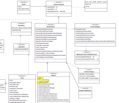

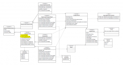

- TransportOrder.vehicleID: optional ID of a specific vehicle that should handle the order
- TransportOrder.vehicleCategories: optional list of categories of vehicles who are allowed to take care. Though you can mention several categories at the order each vehicle belongs to not more than one category (e.g. "with trailer" versus "without trailer")
- TransportOrder.vehicleRequirements and TransportOrder.vehicleExclusions: Another option is to demand or forbid specific equipment, e.g. an order requires a shnickshnack and a firlefanz (ficticious categories 1 and 2). In this case only vehicles with at least the categories 1,2 are allowed.
