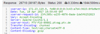

Just in case you could need it: we return the ID that is also written in the xServer logs via the HEADER fields:
- The response headers
Maybe you can use those values to improve the gathering of information.
