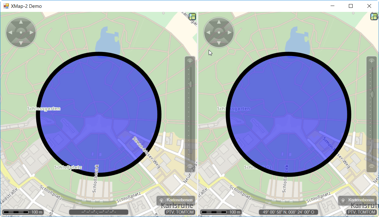

Oookay,
Here's the sample how to use xMapServer(-internet)-2 with xServer.NET. You can download the sample program or get the source code at https://github.com/ptv-logistics/xservernet-bin (XSTwo).
Basic considerations
The sample code uses the xMapServer-2 tile-api with the xServer.NET generic RemoteTiledProvider. There are two basic methods, depending on the application content you want to show on the map. As xMapServer-2 supports zoom-levels up to 22, you should set the option
at the startup of the application.
1. Use xMap2 as single base-map layer
This method just adds the xMap2 as one single base-map layer. It is comparable to the Leaflet sample https://xserver2-europe-eu-test.cloud.p ... ve_map.htm
2. Add two separate basemap-layers
The second method uses two layers for building up the basemap. Application content can then be rendered in-between these xMap layers. It is comparable to the Leaflet sample https://xserver2-europe-eu-test.cloud.p ... m_data.htm
// set the inifinite zoom option to allow high zoom levels for xMap-2
Ptv.XServer.Controls.Map.GlobalOptions.InfiniteZoom = true;
// center and radius for our map
var center = new Point(8.4044, 49.01405);
// the maixum zoom level of the map
formsMap1.MaxZoom = 22;
// set the map center to Karlsruhe
formsMap2.SetMapLocation(center, 16);
// insert base map layer
formsMap1.Layers.Add(new TiledLayer("Background")
TiledProvider = new RemoteTiledProvider
MinZoom = 0,
MaxZoom = 22,
RequestBuilderDelegate = (x, y, z) => string.Format("https://s0{0}-xserver2-europe-test.cloud.ptvgroup.com/services/rest/XMap/tile/{1}/{2}/{3}?storedProfile={4}&xtok={5}",
"1234"[(x ^ y) % 4], z, x, y, "silkysand", myToken)
IsBaseMapLayer = true, // set to the basemap category -> cannot be moved on top of overlays
Icon = ResourceHelper.LoadBitmapFromResource("Ptv.XServer.Controls.Map;component/Resources/Background.png"),
Caption = MapLocalizer.GetString(MapStringId.Background),
Copyright = "PTV, TOMTOM"
// add custom layer
var myLayer = new ShapeLayer("MyLayer");
formsMap1.Layers.Add(myLayer);
AddCircle(myLayer, center, 435);
// the second map instance is initialized with two basemap layers
formsMap2.MaxZoom = 22;
// add a base layer with only background and transport
formsMap2.Layers.Add(new TiledLayer("Background")
MinZoom = 0,
MaxZoom = 22,
RequestBuilderDelegate = (x, y, z) => string.Format("https://s0{0}-xserver2-europe-test.cloud.ptvgroup.com/services/rest/XMap/tile/{1}/{2}/{3}?storedProfile={4}&layers=background,transport&xtok={5}",
// now a custom shape layer in-betwee background and labels
formsMap2.Layers.Add(myLayer);
// now add the labels overlay layer
formsMap2.Layers.Add(new TiledLayer("Labels")
MinZoom = 0,
MaxZoom = 22,
RequestBuilderDelegate = (x, y, z) => string.Format("https://s0{0}-xserver2-europe-test.cloud.ptvgroup.com/services/rest/XMap/tile/{1}/{2}/{3}?storedProfile={4}&layers=labels&xtok={5}",
Icon = ResourceHelper.LoadBitmapFromResource("Ptv.XServer.Controls.Map;component/Resources/Labels.png"),
Caption = MapLocalizer.GetString(MapStringId.Labels),
