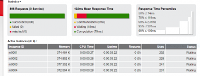

how many backend modules of xMap are accessible behind the service URL?
Is the service OnPremise? Or via xServer INTERNET?
I just configured a 4modules scenario and the filling of the tiles is quite fast (<2seconds) on a full screen (1920x1080).
- screenshot of my local xmap after warmup(10 transactions) and massive user interaction. Looks fast enough.
