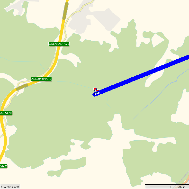

But besides the wrong coordinate format there is an issue with the location specified:
At least the destination coordinate lies in the forrest.
coordinate in the far off...
