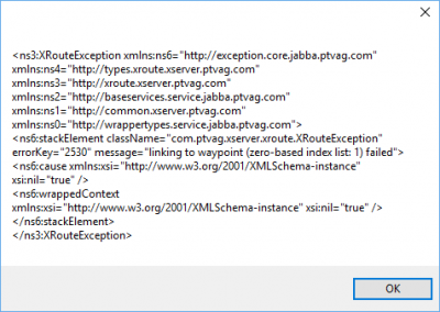

-  LINKING (mandatory): the component attaches each waypoint coordinate to the street network. Sometimes this causes the LINKING error when the given coordinate is too far away from the street network or streets that are enabled for the car (e.g. the coordinate is located in a large pedestrian zone). The error message gives you a hint about the coordinates that caused the error. Imagine you provided 4 waypoints. They will be treated as waypoint_0, waypoint_1, waypoint_2 and waypoint_3. If the 2nd and the last element of the list cause LINKING ERRORs you get the hint linking to waypoint (zero-based index list: 1,3) failed. If at least one coordinate causes an error the routing is not computed but interrupted with the error message.
-  typical linking error message

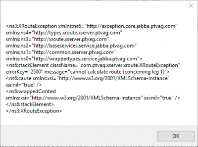

-  Otherwise the ROUTING step (mandatory) is executed: the algorithm computes the path through the road network and determines it's participating nodes and segments and the KPIs (distance, period) of the route. It could happen that this step produces an error if the settings prevent the algorithm from finding a solution (e.g. LONDON to PARIS but ferries are forbidden): cannot calculate route (concerning leg 1). In this case the index 1 refers to the section between waypoint 0 and 1:
