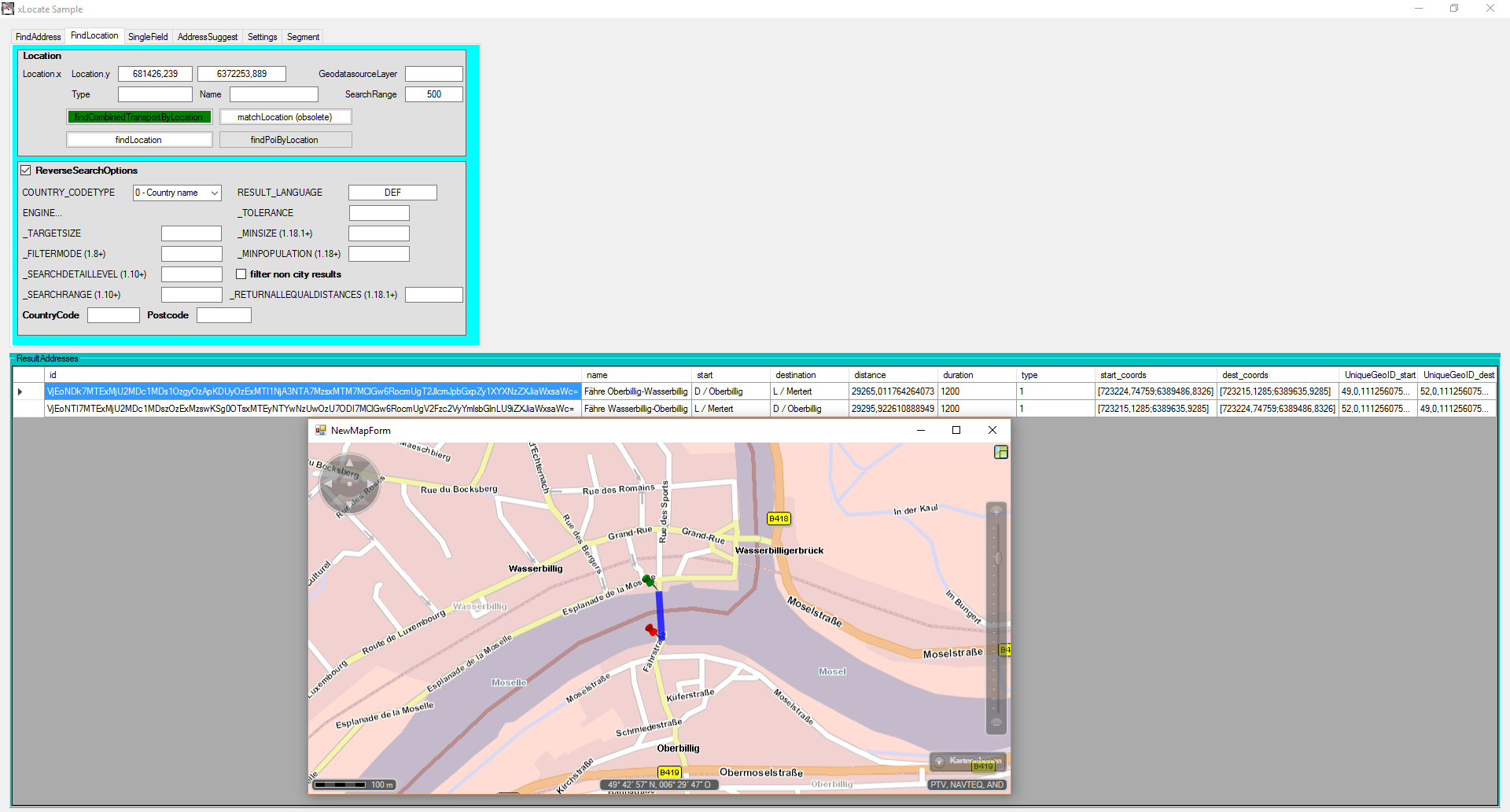

How about using the xLocate.findCombinedTransportByLocation method to look for a ferry?
Sample screenshot taken from xLocate testclient.<br />Result shows some ferry relations near the given input coordinate.

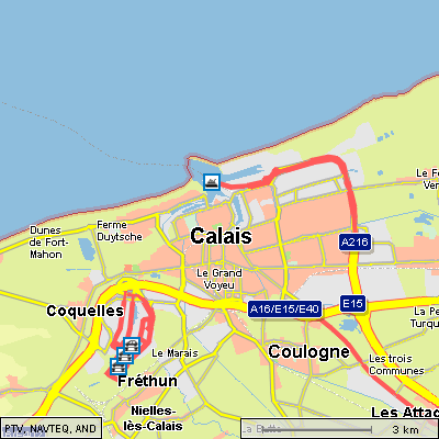

Furthermore you could use the StaticPoiLayer as described here:
Combined transport is a function to add ferries or piggybacks to the route planning as additional stations. Ferries and piggy back stations are displayable as a StaticPoiLayer that is named combined transports. Please note that combined transports are supported only by maps 2012.1 or newer.
screenshot taken from the API documentation (usecase &quot;How to Display Ferries and Piggy Back Stations&quot;)
screenshot taken from the API documentation (usecase "How to Display Ferries and Piggy Back Stations")
