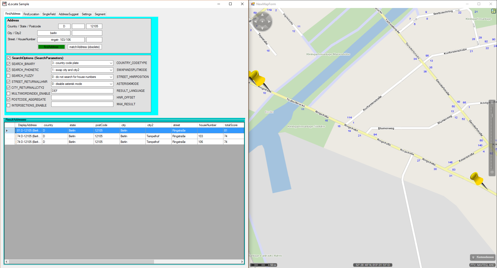

Result after the proposal has been applied
Looks good...
