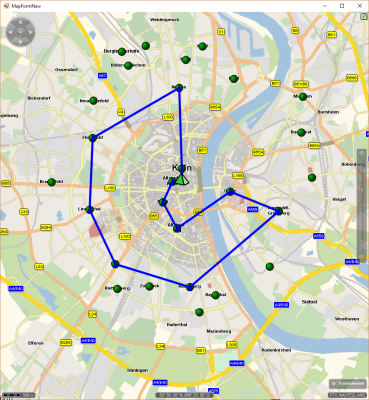

HI there,
these days a community member draw attention to the planning quality with default settings under the following conditions:
  • The number of orders exceeds the available resources.
  • Therefore xTour has to perform a selection of the orders to be prefered

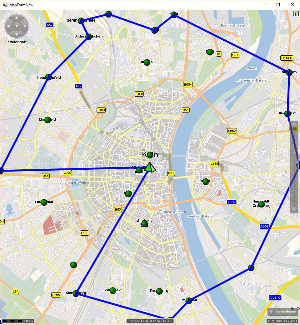

  • Obviously orders far away from the depot seem to be considered
  • This selection produces a result with less orders to be scheduled that possible, the driving distances and periods are greater than wanted.
Orders far away from the depot are considered and this produces a bad performance in terms of efficiency.
There are at least the following two approaches given to increase the quality of the result:
  • Use priorities: assign a higher prio to orders near the depot.

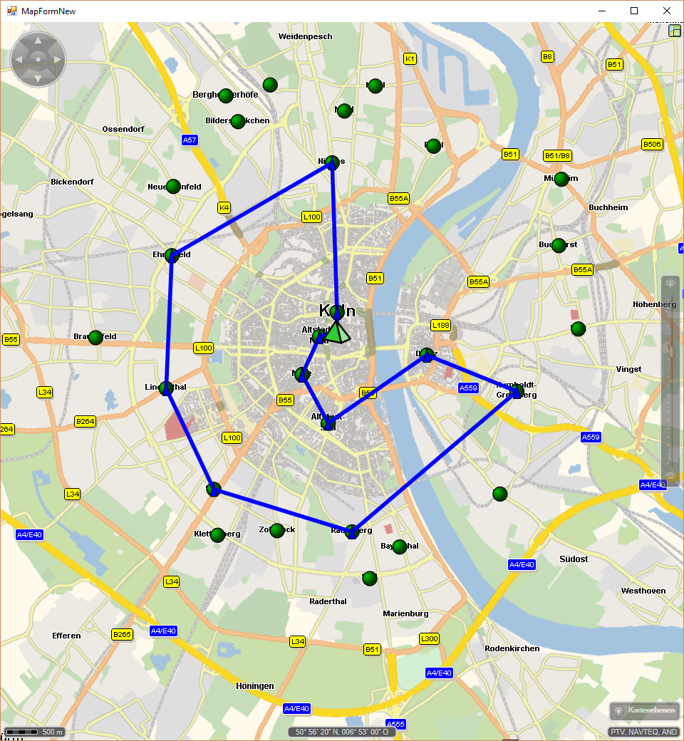

  • Use BasicConstructionMethod="cBasicCMInsertion" in combination with TourOpt.INI section [DoBasicTourPlanning.Insertion]: … SeedCriteria.Strategy= Nearest.
After applying the NEAREST criteriy the quality seems to be better.
:!: Attention: this approach is only meaningful for a single tour. In other cases it may cause results that are even poorer than with SeedCriteria.Strategy= FARTHEST.

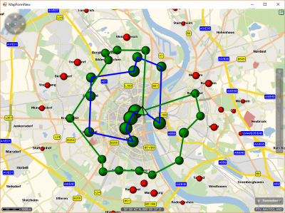

we found a solution for us with the order priority. The changes in Touropt.Ini are too strict for us beause the user cannot change it from usecase to usecase.
We inserted a user definable table in our software where the user can define km-circles (as the crow flies) around the depot and the priority the orders will get in the request if they are located in such a circle.
Example: From 0 to 20km prio 8, from 20 to 60km prio 7, from 60 to 120km, prio 6 and so on.
Works as designed!

There you are right... Check the screenshot: bigger circle means higher prio...
