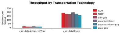

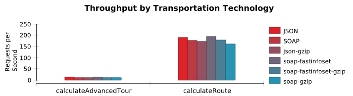

Regarding FastInfoSet, when compared with gzip, it achieves less compression on its own but is much faster to encode an ddecode than gzip alone, faster even than plain XML. When combined with gzip, it will further improve compression a bit but will induce a performance cost, I guess because the binary format makes compression harder.
There are some throughput comparisons in our benchmarks, which are done in a LAN. Here are the results from xRoute 1.18.1 for Windows (Linux looks nearly the same, by the way): These numbers will change when crossing the local network, favoring zipped and fastinfoseted transportation.
With .NET there is an additional problem, however: There is (to our knowledge) no free FastInfoSet library to use. There are commercial variants which we had tested a bit and they seemed to work fine. So, the potential gains are probably not worth paying extra, but if you are looking to squeeze every last bit of efficiency out of your setup, go ahead.

glad that it works now for you
